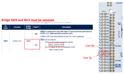

‎2023-10-30 8:52 AM
Check the following:
In order to have the FDCan2 available on the Nucleo board STM32H563 on the corresponding connector strips, the bridges SB29 and SB12 must be removed.
This is described in document UM3115.

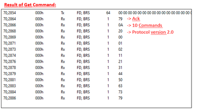

My anwser of get Command.
I hope this helps.
‎2023-11-02 4:06 AM
Thank you so much. This worked for me, although it might not solve the top post here.

I have finally achieved success.
# configure the CANFD driver on Linux:
sudo ip link set can0 up type can bitrate 250000 sample-point 0.75 sjw 16 dbitrate 1000000 dsample-point 0.75 dsjw 4 fd on
# monitor the CAN bus (in a different window/tab):
candump -tdex can0
# send a standard (11-bit) CANFD frame with BRS set, ID=000 and a 64-byte payload:
cansend can0 000##100000000000000000000000000000000000000000000000000000000000000000000000000000000000000000000000000000000000000000000000000000000
# it is important to note in the command above the double-hash (##) which tells cansend that this
# will be a CANFD packet, and then the single '1' before the 64-byte payload which sets the Bit
# Rate Switch (BRS) switch in the outgoing packet.
# observe the CAN traffic in the candump window:
(179.707038) can0 000 [64] 00 00 00 00 00 00 00 00 00 00 00 00 00 00 00 00 00 00 00 00 00 00 00 00 00 00 00 00 00 00 00 00 00 00 00 00 00 00 00 00 00 00 00 00 00 00 00 00 00 00 00 00 00 00 00 00 00 00 00 00 00 00 00 00
(000.001531) can0 000 [01] 79
(000.000025) can0 000 [01] 0B
(000.000009) can0 000 [01] 11
(000.000009) can0 000 [01] 00
(000.000007) can0 000 [01] 01
(000.000008) can0 000 [01] 02
(000.000008) can0 000 [01] 11
(000.000008) can0 000 [01] 21
(000.000008) can0 000 [01] 31
(000.000999) can0 000 [01] 44
(000.000012) can0 000 [01] 63
(000.000006) can0 000 [01] 73
(000.000005) can0 000 [01] 82
(000.000006) can0 000 [01] 92
(000.000006) can0 000 [01] 79
I can issue various commands, including the ID=0 but with no payload at all and get the expected response.
