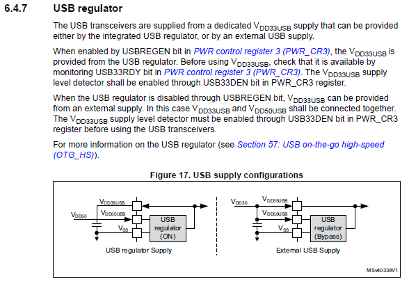

I am trying to start with USB CDC on stm32h7. I create new project with CubeMx + STM32Cube_FW_H7_V1.1.0 (cubemx file attached). After compile usb device doesnt appear on the system.

Hi Mikolaj,
I had the same problem, this function solved it :
HAL_PWREx_EnableUSBVoltageDetector() .
Please add this function call to usb_device.c file like this.
void MX_USB_DEVICE_Init(void)
{ /* USER CODE BEGIN USB_DEVICE_Init_PreTreatment */ /* USER CODE END USB_DEVICE_Init_PreTreatment */ /* Init Device Library,Add Supported Class and Start the library*/ USBD_Init(&hUsbDeviceFS, &FS_Desc, DEVICE_FS);USBD_RegisterClass(&hUsbDeviceFS, &USBD_CDC);
USBD_CDC_RegisterInterface(&hUsbDeviceFS, &USBD_Interface_fops_FS);
USBD_Start(&hUsbDeviceFS);
/* USER CODE BEGIN USB_DEVICE_Init_PostTreatment */
HAL_PWREx_EnableUSBVoltageDetector(); /* USER CODE END USB_DEVICE_Init_PostTreatment */}Hope it helps!

‎2017-11-11 5:34 PM
Its now workingk. Thank you Marina.

Hi Andrei,
I was using this function because the usb voltage on stm32h7 comes from VDD33 voltage level detector.
So the code is actually:
void HAL_PWREx_EnableUSBVoltageDetector(void)
/* Enable the USB voltage detector */
SET_BIT(PWR->CR3, PWR_CR3_USB33DEN);
Is stm32f767 has a USB regulator that needs to be enabled?

,ST team is aware about the issue ofmissing call to HAL_PWREx_EnableUSBVoltageDetector( ) and should fix this limitation in the coming release, but all
depends on releases planning and expected fixes or new features to embed.
It should be better to start a new discussion for new issue with more details even if the topic is the same.
