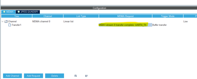

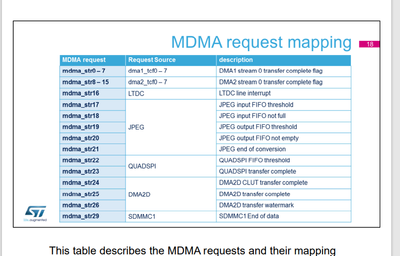

I would like to transfer 3 linked list blocks over UART DMA. When I started HAL_MDMA_START_IT, it transmits only 16 bytes. How can I send big files back to back? Configurations are as follows:
MCU : STM32H7 series
Firmware : Last release
15 REPLIES 15

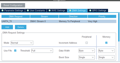

UART_HandleTypeDef huart4;
DMA_HandleTypeDef hdma_uart4_tx;
MDMA_HandleTypeDef hmdma_mdma_channel0_sw_0;

  * Enable DMA controller clock
static void MX_DMA_Init(void)
  /* DMA controller clock enable */
  __HAL_RCC_DMA1_CLK_ENABLE();
  /* DMA interrupt init */
  /* DMA1_Stream0_IRQn interrupt configuration */
  HAL_NVIC_SetPriority(DMA1_Stream0_IRQn, 0, 0);
  HAL_NVIC_EnableIRQ(DMA1_Stream0_IRQn);

  /* Configure MDMA channel MDMA_Channel0 */
  /* Configure MDMA request hmdma_mdma_channel0_sw_0 on MDMA_Channel0 */
  hmdma_mdma_channel0_sw_0.Instance = MDMA_Channel0;
  hmdma_mdma_channel0_sw_0.Init.Request = MDMA_REQUEST_SW;
  hmdma_mdma_channel0_sw_0.Init.TransferTriggerMode = MDMA_BLOCK_TRANSFER;
  hmdma_mdma_channel0_sw_0.Init.Priority = MDMA_PRIORITY_VERY_HIGH;
  hmdma_mdma_channel0_sw_0.Init.Endianness = MDMA_LITTLE_ENDIANNESS_PRESERVE;
  hmdma_mdma_channel0_sw_0.Init.SourceInc = MDMA_SRC_INC_BYTE;
  hmdma_mdma_channel0_sw_0.Init.DestinationInc = MDMA_DEST_INC_DISABLE;
  hmdma_mdma_channel0_sw_0.Init.SourceDataSize = MDMA_SRC_DATASIZE_BYTE;
  hmdma_mdma_channel0_sw_0.Init.DestDataSize = MDMA_DEST_DATASIZE_BYTE;
  hmdma_mdma_channel0_sw_0.Init.DataAlignment = MDMA_DATAALIGN_PACKENABLE;
  hmdma_mdma_channel0_sw_0.Init.BufferTransferLength = 32;
  hmdma_mdma_channel0_sw_0.Init.SourceBurst = MDMA_SOURCE_BURST_SINGLE;
  hmdma_mdma_channel0_sw_0.Init.DestBurst = MDMA_DEST_BURST_SINGLE;
  hmdma_mdma_channel0_sw_0.Init.SourceBlockAddressOffset = 0;
  hmdma_mdma_channel0_sw_0.Init.DestBlockAddressOffset = 0;
  if (HAL_MDMA_Init(&hmdma_mdma_channel0_sw_0) != HAL_OK)
    Error_Handler();

Hello @farukisiker
Unfortunately, you cannot not use UART with MDMA in linked list mode. There not MDMA Request for UART peripheral.
Please see the document below for more details:
STM32H7-System-Master direct memory access controller (MDMA)
In the driver also you can see that there is no MDMA request for UART.

1- If it does not support, why it sends some bytes when I start mdma interrupt?
if (HAL_MDMA_Start_IT(&hmdma_mdma_channel0_sw_0, (uint32_t)tx_1, (uint32_t)&huart4.Instance->TDR, 32, 1) != HAL_OK)
 2-I uploaded an image about how I configured UART4 dma request. According to request mapping, I am supposed to able to connect dma 1 stream 0 to mdma list. If so, how can I do it?
Hello @farukisiker
DMA1 should be first configured to transfer data from the USART peripheral to a buffer in memory. Once the DMA transfer is complete, MDMA is hardware-triggered to take over. MDMA then moves the data from the DMA-accessible buffer to another memory region.
