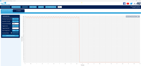

When I run the sample project without any modification, I measure about 255 µA. This is much higher than the expected value in the user manual.

Hello @AkasaDesu_1840 and welcome to the community;
Could you check your measuring device?
I recommend you to follow these steps:
- Debug PWR_STANDBY example
- Run the example.
- Stop run
- Remove JP4
- Connect an amperemeter to JP4 to measure IDD current.
On my side I tested the PWR_STANDBY example and I found that the standby current consumption is 0.6µA
Also, I used STLINK-V3PWR and I found the same results
Thank you.

Hello @KDJEM.1
Thank you for your response, and sorry for my late reply.
I was able to achieve a similar standby current to the user manual by following your method.
