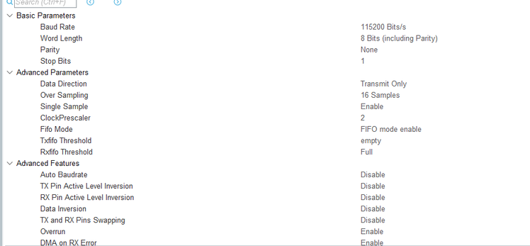

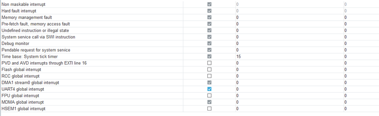

I would like to transfer 3 linked list blocks over UART DMA. When I started HAL_MDMA_START_IT, it transmits only 16 bytes. How can I send big files back to back? Configurations are as follows:
MCU : STM32H7 series
Firmware : Last release

I haven't tried that solution yet. Should I close that topic till trying?
In NUCLEO-U575 example includes "DMA_QListTypeDef" structure at stm32u5xx_hal_dma_ex.h. However, it is not defined in H7 library. And, queue is created around this structure.

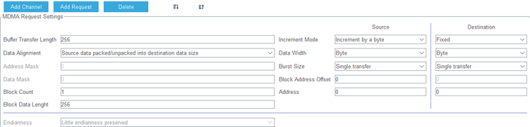

In this example, we do not forward all buffers to an interface like UART tx buffer. I already can transfer datas between memory by using MDMA. My problem is with peripheral interface. I want to forward 3 buffers to uart tx buffer back to back.
mdmaLinkNodeConfig.SrcAddress = (uint32_t)SRC_Const_Buffer1;
mdmaLinkNodeConfig.DstAddress = (uint32_t)DESTBuffer1_SRAM1;
mdmaLinkNodeConfig.BlockDataLength = (BUFFER_SIZE1*4);
mdmaLinkNodeConfig.BlockCount = 1;
mdmaLinkNodeConfig.SrcAddress = (uint32_t)SRC_Const_Buffer2;
mdmaLinkNodeConfig.DstAddress = (uint32_t)DESTBuffer2_AHBSRAM;
mdmaLinkNodeConfig.BlockDataLength = (BUFFER_SIZE2*4);
if (HAL_MDMA_Start_IT(&MDMA_Handle, (uint32_t)&SRC_Const_Buffer0, (uint32_t)&DESTBuffer0_AXISRAM, (BUFFER_SIZE0 * 4), 1) != HAL_OK)
Hello @farukisiker
Could you please share your code for UART MDMA transfer? The code you shared is for memory-to-memory transfer.
