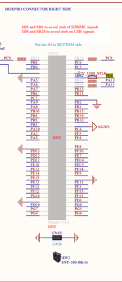

To test it, connect the PD8 pin to the PD9 pin to attach USART3 TX to USART3 RX.

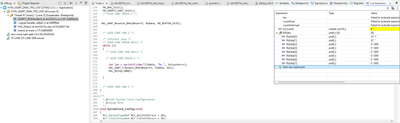

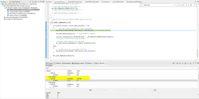

Set a breakpoint at the following line of code to ensure you do not miss the RTOF bit being set:
HAL_GPIO_WritePin(GPIOB, GPIO_PIN_14, GPIO_PIN_SET);
You can visualize this using the SFR window.

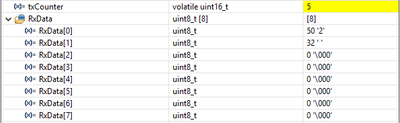

You can see that RX receives the number using the live expression buffer RXdata, and RTOF is 0.

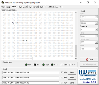

Hello , Gyessine. Do you sure about DMA save date in buffer? I have very strange situation. The counter of received bytes is real, but buffer is empty. I send on other UART length and write two bytes in DMA buffer to see how change it DMA, but is not changed.

I check and memory increment is OK.
this is from serial monitor:
79 is real data length , 57 are bytes that can be changed if DMA write something in buffer.
