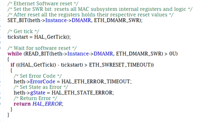

I am using STM32H573 and trying to enable ethernet. I have used the below article for it:
https://community.st.com/t5/stm32-mcus/how-to-use-the-lwip-ethernet-middleware-on-the-stm32h5-series/ta-p/691100
But ethernet is not being initialized. The HAL_ETH_Init is returning error which is resulting in error handler.
This is the condition being checked in MX_ETH_Init function. As even after using the steps mentioned in the article mentioned above the ethernet is not working.
- Do we have to add RX and TX descriptors specific addresses in the linker file?
So what error, exactly, is it returning ?
Have you stepped into HAL_ETH_Init to see where and why it is failing ?

@Andrew Neil In HAL_ETH_Init: From here HAL_ERROR is returned.
The ETH_DMAMR_SWR is always set.

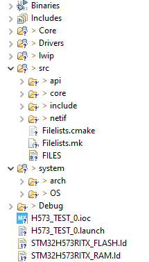

@mbarg.1 I have attached the .ioc and main.c file. About Middleware I have taken src and systems from
stm32h5-classic-coremw-apps/Projects/STM32H573I-DK/Applications/LwIP at main · STMicroelectronics/stm32h5-classic-coremw-apps

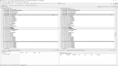

I downloaded example Nx_WebServer for STM32H573IIKX; comparing 2 .ioc, I noted that Ethernet frequency in your project is very different from STM example:
Any reason for this difference?
Also other settings are different, please double check.
Mike

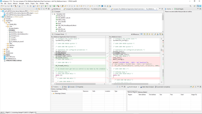

More:
 in main.c i do not see you calling MX_ETH_Init() - it is where you set all Eth params !
Attached my project.
MX_ETH_Init is being called in low_level_init

@mbarg.1 I tried after changing the Ethernet clock frequency as per the example and also initialized ethernet before calling Network_config. Yet same result
First: something MUST be the problem, never forget this; many people run this device without problems.
Next step is to see differences between your code and exampe I did attach to previous post.
Or add code of lwip_init() and let me try to understand what happens.
