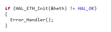

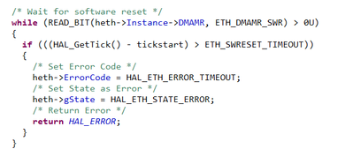

But ethernet is not being initialized. The HAL_ETH_Init is returning error which is resulting in error handler.
This is the condition being checked in MX_ETH_Init function. As even after using the steps mentioned in the article mentioned above the ethernet is not working.

After multiple tries I check on the hardware side and the problem was there. After proper connections on the hardware the problem was solved.

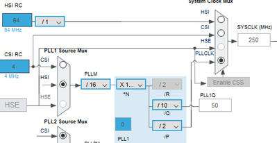

As I have mentioned above the issue lies due to wrong configuration of clock. Due to which the ETH_DMAMR_SWR is always SET.

  heth.Instance = ETH;
  MACAddr[0] = 0x00;
  MACAddr[1] = 0x80;
  MACAddr[2] = 0xE1;
  MACAddr[3] = 0x00;
  MACAddr[4] = 0x00;
  MACAddr[5] = 0x00;
  heth.Init.MACAddr = &MACAddr[0];
  heth.Init.MediaInterface = HAL_ETH_RMII_MODE;
  heth.Init.TxDesc = DMATxDscrTab;
  heth.Init.RxDesc = DMARxDscrTab;
  heth.Init.RxBuffLen = 1524;
  /* USER CODE BEGIN MACADDRESS */
  /* USER CODE END MACADDRESS */
  if (HAL_ETH_Init(&heth) != HAL_OK)
    Error_Handler();

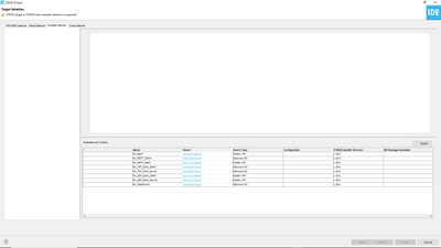

 Moreover, there are no LWIP examples on STM32H573.
For examples, see "X-cube-classic-coremw" on STMicroelectronics github:
STM32H573:
stm32h5-classic-coremw-apps/Projects/STM32H573I-DK/Applications/LwIP at main · STMicroelectronics/stm32h5-classic-coremw-apps
STM32H563 (more examples, should be easily adaptable to STM32H573):
stm32h5-classic-coremw-apps/Projects/NUCLEO-H563ZI/Applications/LwIP at main · STMicroelectronics/stm32h5-classic-coremw-apps
