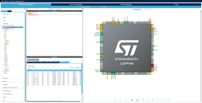

1.1. Project configuration

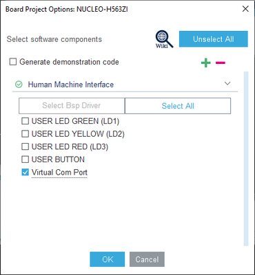

Start by creating a new project using the STM32CubeIDE by clicking [File->New->STM32 Project]. Use the [Board Selector] tab and select the [NUCLEO-H563ZI]. In the board project options that pop up, select only the [Virtual Com Port] and press [OK]. The LEDs are used, but the names given are changed to facilitate the color identification.
Figure 1 - Board Support ConfigurationFigure 1 - Board Support Configuration
Once the project creation is done, enable the [ETH] peripheral in RMII mode, located in the [Connectivity] section.
Figure 2 - Ethernet settingsFigure 2 - Ethernet settings

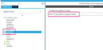

Next, configure the [ICACHE] in 1-way mode
Figure 3 - ICACHE settingsFigure 3 - ICACHE settings
Rename the following pins accordingly, using the user label feature to have the LED’s colors reflected properly:
  • PF4 – LED_YELLOW
  • PG4 – LED_RED
  • PB0 – LED_GREEN

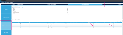

The last configuration before generating the code snippet is not to generate the MX_ETH_Init function call and make it not static. This is done in the [Project Manager] tab, in the [Advanced Settings] section:
Figure 4 - Project Settings CustomizationFigure 4 - Project Settings Customization
Generate the code by clicking on the highlighted icon, or just pressing the [Alt + K] shortcut.
Figure 5 - Code GenerationFigure 5 - Code Generation

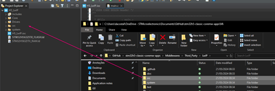

Start by downloading the stm32h5-classic-coremw package available on the GitHub link here, or at the beginning of the article. Make sure to perform a Git Clone, otherwise the required files are not downloaded.
Unzip the cloned file and move to the following folder ..\stm32h5-classic-coremw-apps\Middlewares\Third_Party\LwIP. [Ctrl + left click] to select both the “src” and “system” folders, then drag and drop it to your newly created project, as illustrated below:

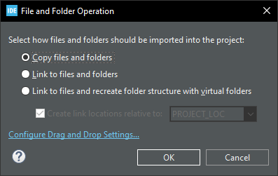

Figure 6 - Add LwIP step 1Figure 6 - Add LwIP step 1
Select [Copy files and folders] in the pop-up tab and click [OK]
Figure 7 - Add LwIP step 2Figure 7 - Add LwIP step 2

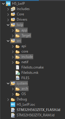

Next up we need to change these regular folders into source folders. To do that, [right-click] the project and navigate the menu [> new > source folder], and create two source folders with the same exact name of the folders you just imported. If done correctly, a small C letter is added to the folders, as shown below:
Figure 8 - Add LwIP step 3Figure 8 - Add LwIP step 3
As none of the Ethernet protocols are used for this simple demonstration, we should delete the ‘src/apps’ folder before proceeding.

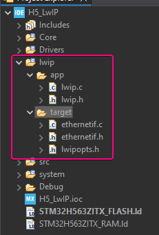

Create a new source folder called ‘lwip’, and inside it create normal folders named ‘app’ and ‘target’. These are going to be the user code folders for the middleware, maintaining a similar folder structure provided in our other series for the LwIP.
Figure 9 - Add LwIP step 4Figure 9 - Add LwIP step 4
The application files must be imported from the stm32h5-classic-coremw package. Following this path ..\stm32h5-classic-coremw-apps-main\Projects\NUCLEO-H563ZI\Applications\LwIP\LwIP_TCP_Echo_Server\LWIP\Target, import all the ‘target’ folder files to the ‘target’ folder in your project. In the “app” folder, create lwip.c and lwip.h files.
Figure 10 - Add LwIP step 5Figure 10 - Add LwIP step 5

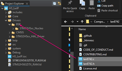

Finally, from ..\stm32h5-classic-coremw-apps-main\Drivers\BSP\Components\lan8742 path, import both lan8742.c and lan8742.h to the “BSP” folder.
Figure 11 - Add LwIP step 6Figure 11 - Add LwIP step 6

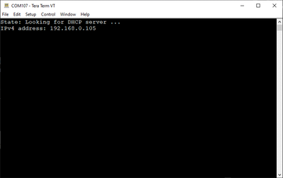

The next addition is the DHCP process. It checks DHCP state machine and handle the ip addressing, as well as print it out once it is acquired:
#if LWIP_DHCP
 * @brief DHCP_Process_Handle
 * None
 * @retval None
void DHCP_Process(struct netif *netif)
 ip_addr_t ipaddr;
 ip_addr_t netmask;
 ip_addr_t gw;
 struct dhcp *dhcp;
 switch (DHCP_state)
 case DHCP_START:
 printf("State: Looking for DHCP server ...\n");
 HAL_GPIO_WritePin(LED_GREEN_GPIO_Port, LED_GREEN_Pin, GPIO_PIN_RESET);
 HAL_GPIO_WritePin(LED_YELLOW_GPIO_Port, LED_YELLOW_Pin, GPIO_PIN_RESET);
 ip_addr_set_zero_ip4(&netif->ip_addr);
 ip_addr_set_zero_ip4(&netif->netmask);
 ip_addr_set_zero_ip4(&netif->gw);
 dhcp_start(netif);
 DHCP_state = DHCP_WAIT_ADDRESS;
 break;
 case DHCP_WAIT_ADDRESS:
 if (dhcp_supplied_address(netif))
 DHCP_state = DHCP_ADDRESS_ASSIGNED;
 HAL_GPIO_WritePin(LED_GREEN_GPIO_Port, LED_GREEN_Pin, GPIO_PIN_SET);
 char ip_str[16];
 ip4_addr_set_u32(&ipaddr, netif_ip4_addr(netif)->addr);
 ip4addr_ntoa_r(&ipaddr, ip_str, sizeof(ip_str));
 printf("IPv4 address: %s\n", ip_str);

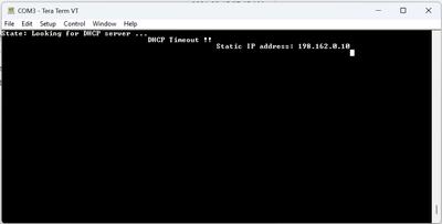

 else
 dhcp = (struct dhcp *)netif_get_client_data(netif, LWIP_NETIF_CLIENT_DATA_INDEX_DHCP);
 /* DHCP timeout */
 if (dhcp->tries > MAX_DHCP_TRIES)
 DHCP_state = DHCP_TIMEOUT;
 /* Static address used */
 IP_ADDR4(&ipaddr, IP_ADDR0 ,IP_ADDR1 , IP_ADDR2 , IP_ADDR3 );
 IP_ADDR4(&netmask, NETMASK_ADDR0, NETMASK_ADDR1, NETMASK_ADDR2, NETMASK_ADDR3);
 IP_ADDR4(&gw, GW_ADDR0, GW_ADDR1, GW_ADDR2, GW_ADDR3);
 netif_set_addr(netif, &ipaddr, &netmask, &gw);
 char ip_str[16];
 printf("DHCP Timeout !! \n");
 printf("Static IP address: %s\n", ip_str);

Press the [run] or [debug] button to get the application started. The green LED turns on and the following message is displayed:
Figure 13 - Demo ResultFigure 13 - Demo Result

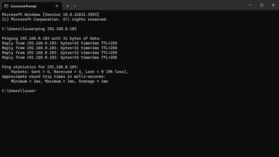

To make sure the board is connected and working, you can open the cmd.exe or similar and issue a ping command, as illustrated below:
Figure 14 - Optional CommandFigure 14 - Optional Command

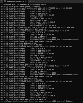

Oct 8, 2024 12:26 PM UTC
Hi
I get static IP : from print : Static IP address: 198.162.0.1
What I miss?

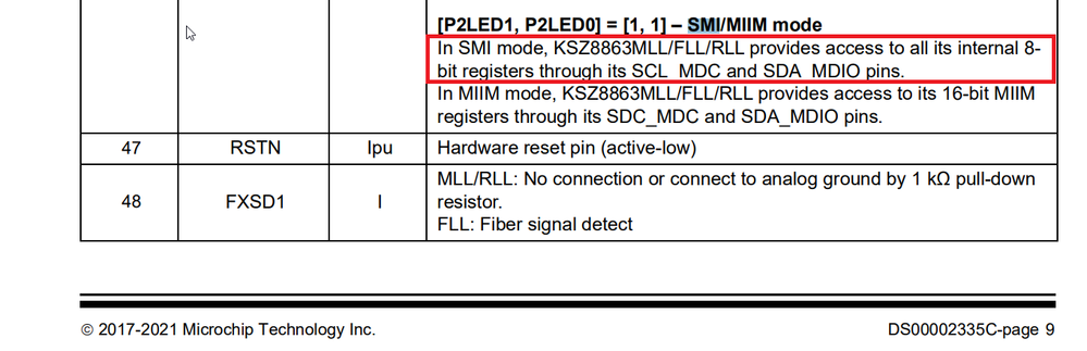

Do you know how to connect a Ethernet Switch chip (MAC) ? that means there is no PHY device. There is only RMII interface between STM32 and switch chip, without MDIO/MDC.
Any advice is highly appreciated

I would also be interested in something similar as @Peter3718, i'm trying to interface with the KSZ8863 PHY. CubeMX generates the MDC and MDIO pins no option to disable them. Any suggestions how to implement the settings of the phy by I2C trough the H5?
Thank you in advance.

If a switch does not have a PHY, then it does not have a PHY and you can not receive or send anything.
@flightorlop
The KSZ8863 has an SMI interface, see here:
I am using a single pair Ethernet switch with an integrated virtual PHY from microchip and it works great together with the STM32 MAC.
Regards,

Thank you @RomThi for your response.
I'm having access to all the registers trough I2C, I need to configure register 198[3] to set the correct clock mode [5] of the KSZ8863. Switch functionality works. But now I'm facing the challenge on how to change the STM32 LAN8742 driver to use I2C to setup the KSZ8863? Which is normally done automatically by Cube by generating the MDIO and MDC pins in combination with the LAN8742 driver?. Or am I missing something?
Any advice would be super helpful.
