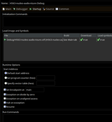

2024-02-20 12:53 AM
If you know, what you want to change - and sure, your right :)
-> can edit in the repo , where cube puzzles code together
-> (..)/STM32Cube/Repository/STM32Cube_FW_H5_V1.1.1/Middlewares/ST/usbx/common/usbx_device_classes/
Look in debug setting: whats set for :: exception on unaligned...
2024-02-20 01:03 AM
This one is not set as on your picture.
I also checked up the corresponding core-register of the cpu, the irq on unalingend is also not set here.
Nevertheless it's firing such an IRQ.
