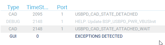

Stefano.Patassa
Dear Yohann,
I've managed to connect a serial port to my board and attached you'll find a screenshot of the trace.
After USBPD_CAD_STATE_ATTACHED_WAIT it is stuck and nothing is detected anymore. If i restart the code i get the EXCEPTION DETECTED message in the trace....
I really do not understand what's going on... Am I missing something?
Yohann M.
Dear Stefano,
CAD is waiting for VBUS setting correctly to 5V to move to ATTACHED state:
static uint32_t ManageStateAttachedWait_SNK(uint8_t PortNum, USBPD_CAD_EVENT *pEvent, CCxPin_TypeDef *pCCXX)
  CAD_HW_HandleTypeDef *_handle = &CAD_HW_Handles[PortNum];
  uint32_t _timing = CAD_DEFAULT_TIME;
  uint32_t CAD_tDebounce = HAL_GetTick() - _handle->CAD_tDebounce_start;
  CAD_Check_HW_SNK(PortNum);
  if (_handle->CurrentHWcondition == HW_Attachment)
    if (CAD_tDebounce > CAD_TCCDEBOUCE_THRESHOLD)
      if (USBPD_TRUE == USBPD_PWR_IF_GetVBUSStatus(PortNum, USBPD_PWR_VSAFE5V)) /* Check if Vbus is on */
        HW_SignalAttachement(PortNum, _handle->cc);
        _handle->cstate = USBPD_CAD_STATE_ATTACHED;
This VBUS value is measured thanks to USBPD_PWR_IF_GetVBUSStatus -> HW_IF_PWR_GetVoltage -> BSP_USBPD_PWR_VBUSGetVoltage.
Normally, you have to configure correctly the ADC to measure this VBUS voltage.
Can you have a look at it?

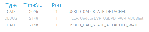

Stefano.Patassa
Hello Yohann,
i have the ADC working and correctly measuring the vbus.
I've added your code in the BSP_USBPD_PWR_VBUSGetVoltage. The function gets called and str buffer is filled correctly but there is nothing on the trace tool!

Hello Stefano,
Fine to see that you applied my recommendations but what it is quite strange is that I cannot see the debug trace "POWER_IF_TRACE(Instance, (uint8_t* )str, strlen(str));" into the cpd file. Can you please check it?
