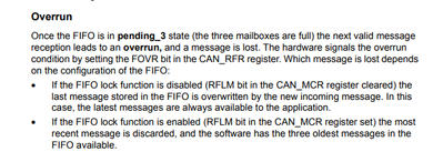

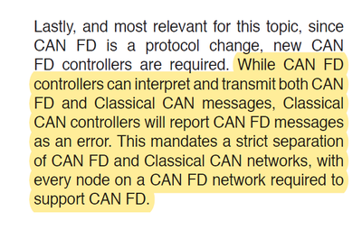

Hi, I am using three STM32 devices for CAN communication:
Hardware
  • Device A: STM32G431 (FDCAN)
  • Device B: STM32F303 (Classic CAN)
  • Device C: STM32H7A3 (FDCAN)
Setup
  • A sends a continuous sequence of commands to B.
  • B processes each command and replies to A over the same CAN bus.
  • One specific command requires B to perform a synchronization sequence with C (also over CAN).
  • While B is synchronizing with C, A continues to send commands to B.
Issue
  • During the B↔C synchronization, B intermittently misses some frames from A (i.e., A transmits, but B does not process/see a corresponding message).
  • The failure is not immediate: A↔B + B↔C run together fine for a while (sometimes short, sometimes long), then a frame from A is skipped.
  • When the synchronization with C is disabled, A↔B runs reliably with no missed frames.
CAN ID from A to B: 0x12C
CAN ID from B to A: 0x12D
CAN IDs between B and C (sync purposes): 0x2BC, 0x2BD and 0x2BE
As you can see from the inserted can config the sampling point for 3 devices is at 87.5%. Bitrate is 500000 bps for three of them.
The CAN configurations for device A:
static void MX_FDCAN1_Init(void)
  /* USER CODE BEGIN FDCAN1_Init 0 */
  /* USER CODE END FDCAN1_Init 0 */
  /* USER CODE BEGIN FDCAN1_Init 1 */
  /* USER CODE END FDCAN1_Init 1 */
  hfdcan1.Instance = FDCAN1;
  hfdcan1.Init.ClockDivider = FDCAN_CLOCK_DIV1;
  hfdcan1.Init.FrameFormat = FDCAN_FRAME_FD_NO_BRS;
  hfdcan1.Init.Mode = FDCAN_MODE_NORMAL;
  hfdcan1.Init.AutoRetransmission = ENABLE;
  hfdcan1.Init.TransmitPause = DISABLE;
  hfdcan1.Init.ProtocolException = DISABLE;
  hfdcan1.Init.NominalPrescaler = 40;
  hfdcan1.Init.NominalSyncJumpWidth = 1;
  hfdcan1.Init.NominalTimeSeg1 = 6;
  hfdcan1.Init.NominalTimeSeg2 = 1;
  hfdcan1.Init.DataPrescaler = 25;
  hfdcan1.Init.DataSyncJumpWidth = 1;
  hfdcan1.Init.DataTimeSeg1 = 6;

Device B. I use two Fifos:
Fifo0: messages from A
Fifo1: messages from C
void HAL_CAN_RxFifo0FullCallback(CAN_HandleTypeDef *hcan)
   while (HAL_CAN_GetRxFifoFillLevel(hcan, CAN_RX_FIFO0) > 0) {
      CAN_RxHeaderTypeDef hdr;
      uint8_t d[8];
      if (HAL_CAN_GetRxMessage(hcan, CAN_RX_FIFO0, &hdr, d) != HAL_OK)
         Error_Handler(); // Handle receive error
      if (hdr.StdId == Sync_Res) {
            syncAckReceived = 1;
            rx1_sync_isr_count++;
            continue;
      uint8_t next = (uint8_t)((RxWrite + 1u) % RXBUFSIZE);
      if (next == RxRead) {
         // overflow: drop oldest (or set a flag/counter)
         g_swDrops++;
         continue;
      // Use real DLC (0..8) and clear tail
      uint8_t dlc = (uint8_t)(hdr.DLC & 0x0Fu);
      if (dlc > 8) dlc = 8;
      RxBuf[RxWrite].id  = hdr.StdId;   // you’re using standard IDs
      RxBuf[RxWrite].dlc = dlc;
      memcpy(RxBuf[RxWrite].data, d, dlc);
      if (dlc < 8) {
         memset(RxBuf[RxWrite].data + dlc, 0, 8 - dlc);
      RxWrite = next;

@RockCoder wrote:
Hi @mƎALLEm ,
FD and Classic cannot coexist on the same pair of wires unless all nodes are FD-capable?
This paper from www.can-cia.orgHybrid CAN and CAN FD networks ,  says:
4 REPLIES 4

Setting BS2 to 1 is not a good idea. Try to increase BS1 and BS2 to increase them as much as possible and decreasing CAN prescaler.
I suggest to use CLASSIC frame format from FDCAN sides instead of  FDCAN_FRAME_FD_NO_BRS.
Try to handle the received frames in a ring buffer filled in the Rx call backs and handled in main.
Play with the Rx interrupt priorities.. Increase it.
Check also if a FIFO overrun has occurred: FOVR bit is set in the CAN_RFR register:
The behavior depends on if the FIFO Lock is enabled or disabled:
Hi @mƎALLEm ,
Thanks for the suggestion. I’d like to sanity-check my bus setup.
  • We have 5+ nodes on the same CAN bus. Only Device B is Classic CAN (bxCAN); the others (including A and C) are FDCAN.
  • Initialization: A/C and the other FD nodes use FDCAN_FRAME_FD_NO_BRS; B is Classic.
  • At runtime:
    • For FD↔FD traffic, A/C set TxHeader.FDFormat = FDCAN_FD_CAN.
    • When A/C talk to B, they switch to TxHeader.FDFormat = FDCAN_CLASSIC_CAN.
Question: On a single physical bus, is this mixed approach actually valid? Or does the presence of a Classic node mean that any FD frame on the wire (even with BRS off) will cause problems—i.e., FD and Classic cannot coexist on the same pair of wires unless all nodes are FD-capable?
@RockCoder wrote:
Hi @mƎALLEm ,
RockCoder
The problem was indeed this. I changed the frame format to CLASSIC frame for all my FD CAN controllers and it solved the problem.
