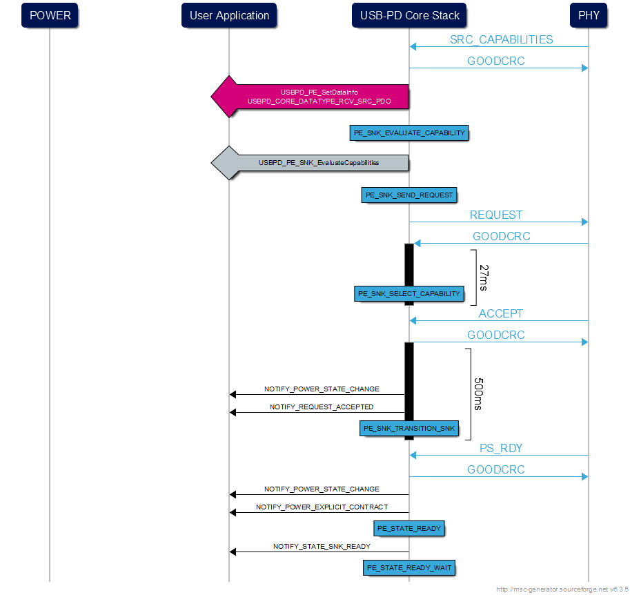

- Did you apply compare your application with Simple application:
I remind here the expected sink power negotiation (described in UM2552 as well):

IT WORKS!
Thank you very much for your help, it was invaluable.
The main improvement was getting the trace work, after that was easy to understand there was some of my code holding up the execution of the USBC code for too long for it to correctly reply to the SRC.
