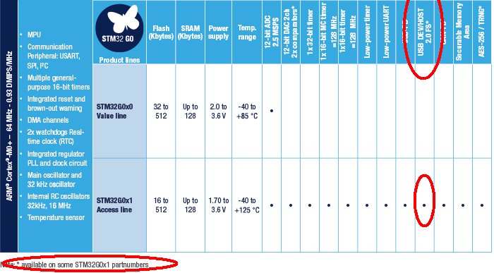

https://www.st.com/en/microcontrollers/stm32g0-series.html?icmp=tt9016_gl_****_dec2018&querycriteria=productId=SS1960 :
but on https://www.st.com/content/st_com/en/products/microcontrollers/stm32-32-bit-arm-cortex-mcus/stm32-mainstream-mcus/stm32g0-series/stm32g0x1.html?querycriteria=productId=LN2048 there is no mention of USB HOST/DEV, not even in the future products.
Is this some oversight, or are 'G0x3 with USB planned?
PS. Can that picture on website be provided in higher resolution, please?

USB HOST/DEV is not supported yet, but the part number supporting it will arrive rapidly.

The G0 series looks like an overhaul of F0. STM32F071 also has no USB, only F072 has. Hopefully a G072 is planned. I Expect the mention of USB on G071 is an error.

OK. IT's been a year... "Can I has USB?"
Still no G0x3 with any USB?
Hi @kyrreaa​ ,
It is in development, target end of next year in mass production.
Best Regards,
Imen
Thanks
Imen
So when you said "the part number supporting it will arrive rapidly", you meant 2 years?
JDUMA
​Hi, the USB is planned in the G0 series by Q2 next year. If you need both USB PD and USB data in your design, I suggest you to have a look on the STM32G4x1 value line series that support those functionalities. Best regards.

The G4x1 have only USB Device. As shown in initial post, the G0 is promised to have HOST/DEV, is that true? If so, will it be again the Synopsys OTG, or something different?

please have a look on the STM32G4 datasheet . It has both USB 2.0 FS data interface and USB PD.
