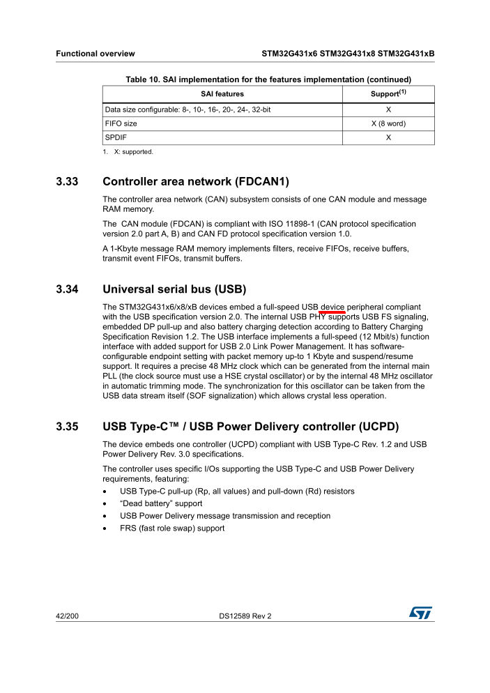

‎2019-11-15 1:27 AM
here an extract of the STM32G431x Datasheet. BR, JP​
‎2019-11-15 1:55 AM
@JDUMA​ ,
I am not talking about PD, it's completely separate from the USB data transfer.
What I am talking about is the USB "data" module. In G4, it is Device only:
but look at the initial post here, it says DEV/HOST, indicating, that G0 might have a USB module capable of being either USB Device or USB Host.
Is this the case, or is that picture a blunder?
‎2019-11-15 2:36 AM
​Yes that's correct (as this is shown in the portfolio overview), new STM32G0Cx are planned by next year with a USB device / host comm interface. Switching from device to host or vice versa will be possible by using "data swap" command encapsulated in the USB PD protocol. BR, JP
‎2019-11-15 2:45 AM
@JDUMA​
Ah, I see, thanks.
And, the second part of my question, is then that device/host module be the Synopsys OTG as used already in 'F4/'higher-end L4/'F7/'H7 (probably in its newer version), or something else?
Thanks,
Jan

‎2025-02-24 10:44 AM
Its strange. For the G071 it doesn't show USB in the data sheet. But the reference manual _still_ has a section for USB even though this MCU does not have this feature.
‎2025-02-24 12:33 PM
It's in'G0B1.
The RM is common to the whole family, and at the beginning there's a chair dealing with availability of peripherals in the individual models.
