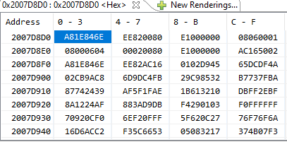

  • SMT32F767ZI + lwIP + FreeRTOS: I tried to build a simple application using the lwIP+FreeRTOS (on a Nucleo-F767ZI board) using STM32CubeIDE (1.5.1). I set up a new project, configured my MCU and tried to ping my board. This, indeed, does not really work. There is a reply to the ping response, but it is a kind of "mysterious" data (a lot of 5s, which looks like a part of the synchronization sequenz of ethernet frame, but this should not be catched by Wireshark, see the attached file). I debugged the lwIP stack down to the point, where the response is sent and I have to say that even the data, which are referenced by the DMA transmit descriptors, seem to be OK (it is not the sequenz of the 5s, which is seen in Wireshark). Is there anybody, who has ever encountered such a problem? As PING packets are received and processed, I assume the basic configuration is OK. FreeRTOS and lwIP are included via the GUI (.ioc) file in STM32CubeIDE, the lwIP settings are nearly unchanged, the settings are: ICMP, TCP and UDP modules are enabled, checksum calculation is done by hardware.

Just more details to the memory sequence shown in the screenshot above (starting at address 0x2007D8D0):
The first six byte (0xA8, 0x1E, 0x84, 0x6E, 0xEE, 0x82) represent the MAC address of the ping request sender (my laptop), the next six byte represent the MAC address of my Nucleo board which responds to the ping (0x00, 0x80, 0xE1, 0x00, 0x00, 0x00). The next two byte define the ethertype (0x0806 for ARP). All following bytes until address 0x2007D8EF contain the ARP request answer, ending with the IP address of my board 0xAC, 0x16, 0x50, 0x02 (equals to 172.22.80.2).
As addition to the first question: during debugging, I also checked the DMACHTBAR register (ethernet DMA current host transmit buffer address register) points to my buffer address 0x2007D8D0.
I have no idea, why there is this sequence of 55:d5:... as the sender's MAC address, I can not explain how my memory data get corrupted.

I wrote a script (Python) to read out the complete SRAM data (address range 0x20000000 - 0x2007FFFF) via UART to see if the data sequence seen in Wireshark (55555d55 57555557 55d5f555 5555fd57 5557fd5f d57fffd7 fd575557 55555555 55555555) is located anywhere in the SRAM.
Result: This sequence or a even a single 8 byte packet like 55555d55 is NOT located anywhere in the SRAM. So maybe it is a hardware problem. Investigations are going on. Another possible reason is that the PHY on the Nucleo board is configured wrong, but I can not see such a problem at the moment (initialization process of the STM32 Cube IDE HAL driver seems to be OK as there are only a few registers written (Basic Control register and Interrupt source flag register).
