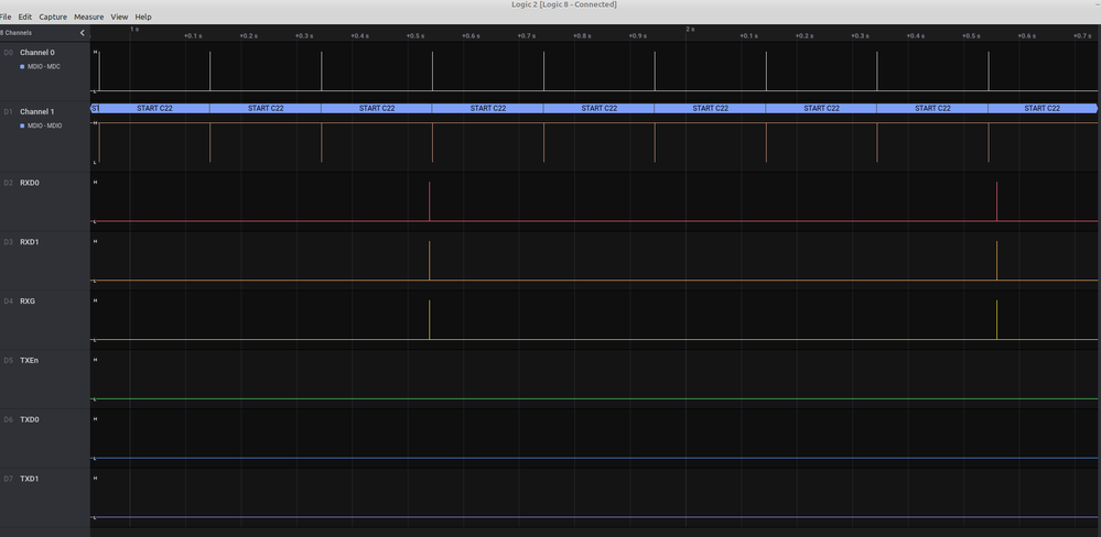

Checked MDIO Bus activity with Saleae Logic 8 pro it show PHY doesn't complete initialization:

  • Simplified MDIO communication
write register 0 phyadd 0 0x8000 (Software reset)
repeatedly read register 0x1f Phyadd 0x1f (??) result 0xffff (Open bus)
read register 1 Phyadd 0 result for a while 0x7809
after many poll status change to 0x782d
write register 0 phyadd 0 0x1000 (Auto Negotiation)
read register 1 Phyadd 0 result 0x782d
read register 0x10 Phyadd 0 result 0x0041
read register 0x1d Phyadd 0 result 0x00ca
write register 0x1d Phyadd 0 result 0x00cb
no more action appear on MDIO bus
No visible activity on rx tx PHY lines
Link led active solid.
Activity led pulse on ping packet

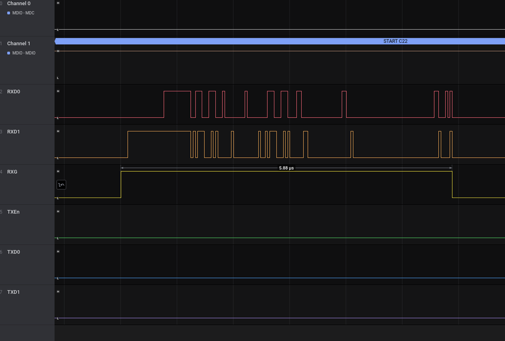

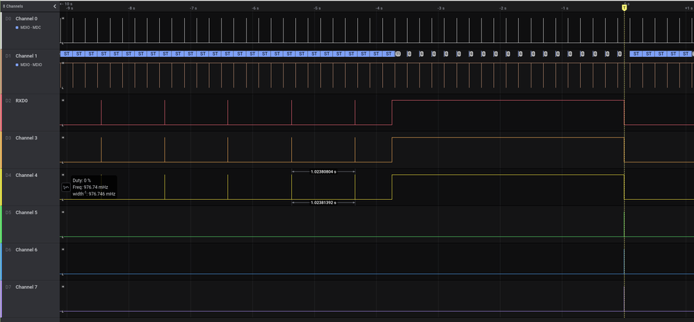

Update:
Connected all RX TX wires to get a more stable probing.
RX Gate and data is present, TX is missing. TX pin tested redeclaring as Output then driving in a sequence. Pin are OK
Work in progress still no idea from where trouble come from.0693W00000D00v1QAB.png0693W00000D011vQAB.pngEdit1: Found some hint from Majerle Tilen Site about Pin A8, try'd use as MCO but nothing changed.

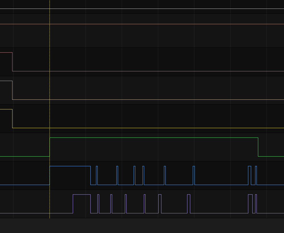

0693W00000D09k0QAB.pngAppended trigger to TXen.
Nothing happen for a long time.
Pressed reset and released, one pulse is transmitted just after release. This time PHY is not ready...
Read errata about network issue on STM32F4x7, nothing appropriate and no mention of irresponsive network..

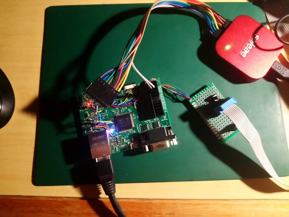

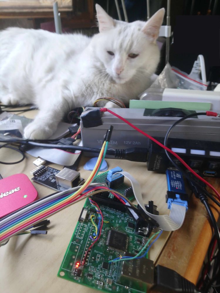

Actual setup
0693W00000D09o2QAB.jpgEdit1: traced both f407 and f429 code Ethernet register access not found. Someone know where MAC registe got accessed from?

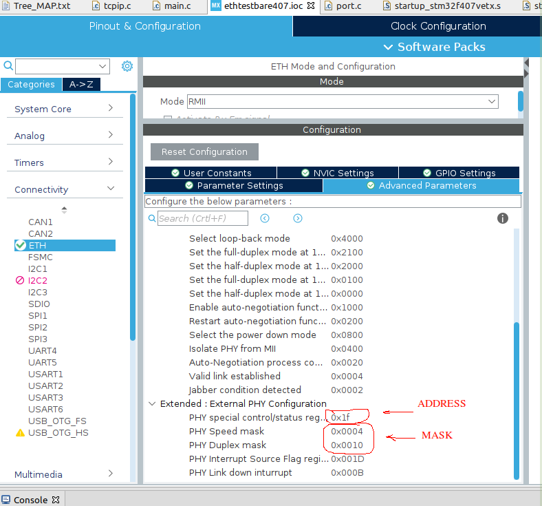

stm32f4xx_hal_eth
on lines 415-479 register 16 of phy is interpreted as autonegotiation result, register 16 or 0x10 is listed on datasheet as EDPD NLP/CROSSOVER TIMEREGISTER
nothing to do with remote party negotiation
Register carrying this information can be 31 or 0x1f PHY SPECIAL CONTROL/STATUS REGISTER
but format is different on list, anyway
bit 4 is duplex PHY_DUPLEX_STATUS must be 0x10 not 4
1 Full
0 Half
Bit 3,2 PHY_SPEED_STATUS is assigned value 2 odd but ok bit 3,2 value must be 4, 8, better to test for right value.
01 10 Base T
10 100 Base T

      HAL_ETH_ReadPHYRegister(&heth, PHY_SR, &regvalue); <<-- // register address required to be 0x1f not 0x10 !!!
      /* Configure the MAC with the Duplex Mode fixed by the auto-negotiation process */
      if((regvalue & PHY_DUPLEX_STATUS) != (uint32_t)RESET) <<-- // value must be 0x10 not 4

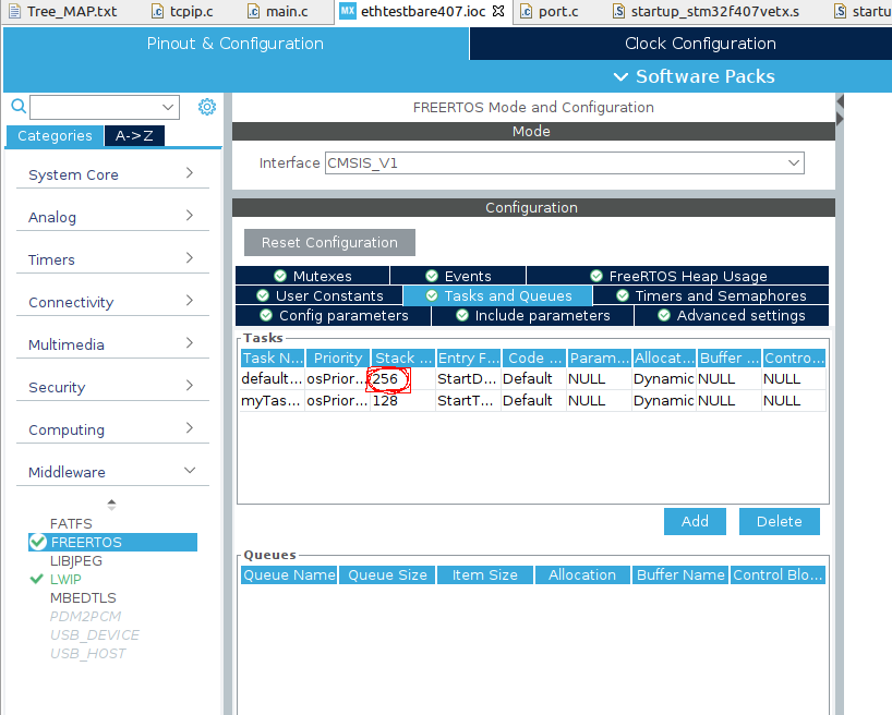

stopping cpu code appear seldom on HardFault, often show port.c lines 754 770 (freezed)
         configASSERT( ucCurrentPriority >= ucMaxSysCallPriority );
Added independent monochromatic blink led on hard fault loop never seen blink nor get solid color.
VCC 3.23V VCAP1=VCAP2 = 1.25V
Commenting out Network init code remaining task work fine.
Feel afraid and extremely scared about this issue as I read across forum plague all Ethernet parts since far past.

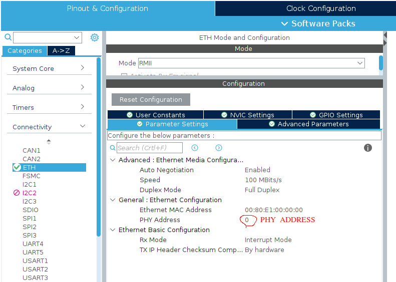

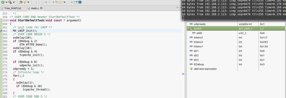

F417, generating a new project:
patching PHY register address,
commenting out all network tasks other than LWIP_Init
got DHCP negotiation:
IP address after negotiation remain zero(??)
0693W00000D0aEfQAJ.png From router table got address, it respond to ping.
Enabled HTTPD, browser work on demo page loading quite fast but slow down a lot during file access.

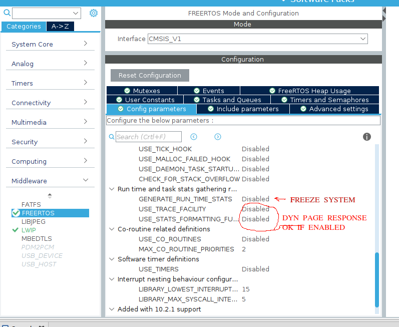

Enabling FreeRTOS config parameters:
USE_STATS_Formatting, USE_TRACE_FACILITY remain up and respond to dynamic page. (after patching stack space)
enabling GENERATE_RUN_TIME_STATS freeze all.
Default task 128Bytes stack is not enough, raised to 256 seems more stable.
One thing is now out: Hardware. At almost 417 one is ok. System is too much unstable and not usable on industrial environment.
Generated another base project targeted to 407VE, as is froze. Applied stack increment to default task respond to ping.
Another strange why are 407 and 417 different, one work as is the other is immediately unstable. (Not hardware but perspective of CubeIde)
Cable MUST be connected at reset otherwise doesn't work.
When network was connected one time at reset, then repeatedly disconnecting and reconnecting network cable ping resume.
  • (Edit August 21) Error come from weird code that disable interface instead of managing link up and down.
407 board maybe damaged, doesn't work, just wait some new 407 I ordered. When arrive try rework both mcu and PHY.
0693W00000D0a0dQAB.png0693W00000D0a0TQAR.png0693W00000D0a0OQAR.png0693W00000D0a0EQAR.png
rromano001
Senior
Updated Cubeide to new version 1.7.0:
many RTOS setting reverted to default, all parameter listed need be checked again.
New fresh project now respond to ping. PHY Address still set to 1 when all board use 0. Status register address still 0x10
Old project after restoring settings respond to ping but HTTP task is no more working. (Work in progress)
