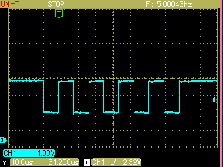

For many hours now I am trying to send couple bytes using uart on stm32f4 board. I tried Usart1 and Uart4 but it doesnt send anything. I have a scope attached to TX pin and there is nothing. Here is my code:
https://pastebin.com/qyVhySzU
I am using HAL. The clock is configured correctly, even if it wasnt I would see anything on the TX pin... I would really aprichiate all help, I have searched everywhere for an answer.

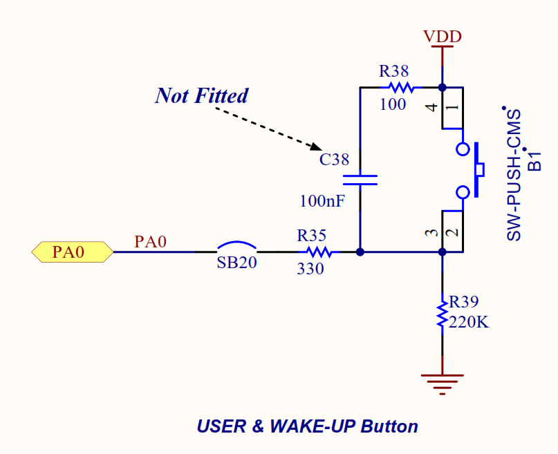

I have just noticed that my configuration works, but I havent seen it, because the signal amplitude is 1.5V, instead of 3.3V as I expected... I checked the STM32F4 discovery schematic and noticed that PA0 is biased (It shouldnt have anything to do with it though). But to be sure i swapped to uart5, but there amplitude is 1.5V as well. Is there something I forgot or dont know about? Are IO's in stm32f4 powered with 1.5V?

PA0 is hooked up to the User Button. Try Usart 2 or 3 they are free on the F4 discovery.  You can remove jumper SB20 to isolate the pin adn use it for the USART.

Hello and thank you for answers. I have checked the schematic and the button connected has no effect on the line.
Even though, I have changed the config to uart2. The amplitude remains about 2 V...
Does anyone understand this?
