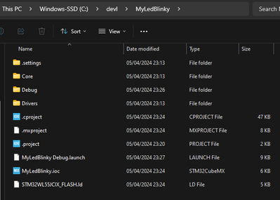

‎2024-04-05 3:53 PM
Hi grway,
Yes I did get it to work back when I had the problem. I just found some notes that I took at the time. Following the taken notes I have just been able create a led blinky project named LEDBlinky in STM32CubeIDE and rename the project to MyLedBlinky, I also changed the .ioc file, built the project and it all seems to work fine so below are the steps that I followed.
- Using file explorer navigate to where your project is located and find the .cproject, .project and LEDBlinky.ioc file
- Using an editor such as Notepad++ open each file and replace the project name globally for example if my project was initially named LEDBlinky do a search and replace all occurrences of this name for example rename to my MyLedBlinky
- Rename your project directory as well to new name for example /path/to/dir/LEDBlinky to /path/to/dir/MyLedBlinky
- Rename the LEDBlinky.ioc to MyLedBlinky.ioc
- Open your .MyLedBlinky.ioc file using STM32CubeMX and make changes to your MyLedBlinky.ioc file as required. (Make sure you don't try and edit file with STM32CubeIDE)
- Save the MyLedBlinky.ioc file and close STM32CubeMX
- Now open the project using STM32CubeIDE by going to main menu and selecting "Open Projects from File System"
- Navigate to the renamed directory and open the project. It should now build.
I hope this helps.
