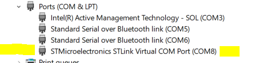

The example code seems to run fine except the printf() output goes to the Terminal I/O window in the IDE. Not out the UART or Virtual USB com port.
I want printf() to send data out USART2. And if it did,  think I would also see the data on the Virtual USB Com Port too. In device manager I do get this:
So that is a good sign.

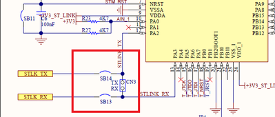

From the code snippet you shared, it desn't seem to be the native example provided in this path: Projects\STM32F401RE-Nucleo\Examples\UART\UART_Printf
I can see:
/* USER CODE END 3 */
Which concludes you're using CubeMx and you did some modifications by inspiring from the example.
Start by compiling the native example and program your target board with it to ensure the HW is fine.
What about the pins you have configured for USART2: are they PA2 (Tx) and PA3 (Rx)?
Check your HW:
CN3 jumper should be off.
SB13 should be soldered.
