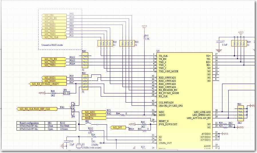

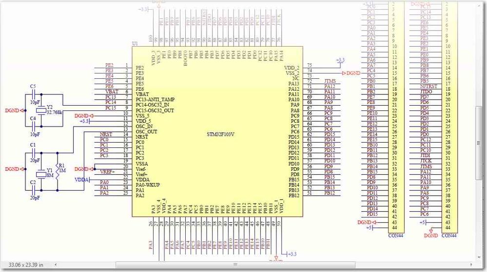

Well the STM32 part is unreadable.
The PHY part, you have no pull-up on PWRDWN_INT, RBIAS has a 4K7 to an unconnected net, Neither pin 38 or 39 are connected properly to the STM32, pin 40 shouldn't need to be.Up vote any posts that you find helpful, it shows what's working..

Here's STM32 schematic......on the chip area, it's simple.....I don't put anything special.... some capacitors and power supply are not displayed......making the image smaller and can't be seen......accept I can send the pdf file....attached...- Mark as New

Ok, figured out what you're doing with the RBIAS.
The pin 39/40 stuff troubles me16 PC1 ETH_MDC Pin 31
24 PA1 ETH_REF_CLK Pin 38 ETH_RMII_REF_CLK
25 PA2 ETH_MDIO Pin 30
32 PA7 ETH_CRS_DV Pin 39 PD8 ETH_RMII_CRS_DV ETH_MII_RX_DV
33 PC4 ETH_RXD0 Pin 43 PD9 ETH_RMII_RXD0
34 PC5 ETH_RXD1 Pin 44 PD10 ETH_RMII_RXD1
48 PB11 ETH_TX_EN Pin 2
51 PB12 ETH_TXD0 Pin 3
52 PB13 ETH_TXD1 Pin 4
Take a look at the STM32MICOS-EVAL schematic cited earlier
Need to look at the 25 MHz vs 50 MHz clock for the PHY

Here's my board configuration, defined from STM32CubeMx...
/**ETH GPIO Configuration PC1 ------> ETH_MDC PA1 ------> ETH_REF_CLK PA2 ------> ETH_MDIO PA7 ------> ETH_CRS_DV PC4 ------> ETH_RXD0 PC5 ------> ETH_RXD1 PB11 ------> ETH_TX_EN PB12 ------> ETH_TXD0 PB13 ------> ETH_TXD1 Do I miss something here ? from this link : http://www.st.com/st-web-ui/static/active/en/resource/technical/layouts_and_diagrams/schematic_pack/stm322xg-eval_sch.zip- Mark as New
‎2015-07-31 6:56 AM
Do you reckon I connect pin 39 to PA7 ? I can give a try by patching the pcb....thanks
‎2015-07-31 9:35 PM
I changed it to pin 39, and I could not get MAC address yet...
