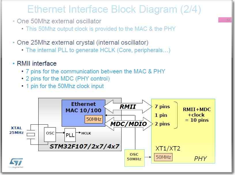

clive,
My board is using 8MHz external crystal, may be it's the cause ?
I saw in on design , I must use 25MHz with this method...
HCLK value ? Must be 25MHz ? thanks
Posted on July 29, 2015 at 14:28
My board is using 8MHz external crystal, may be it's the cause ? I saw in on design , I must use 25MHz with this method...
I don't believe it's a requirement, it does permit designs with a single crystal. What does have to happen is that you change default settings for the PLL and HSE_VALUE, so they are consistent/coherent with the clock source you are providing.

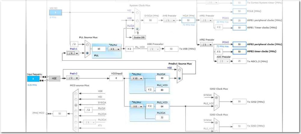

antonius
Senior
Posted on July 29, 2015 at 15:02
Is my clock configuration acceptable ?
I make it with STM32CubeMx

Posted on July 30, 2015 at 15:11
The DP83848 manual should contain the register/bit definitions.
Not sure why you're clocking the CPU at 50 MHz, I'd think the PLL would permit 72 MHz operation. Assuming your PHY has it's own crystal, lacking a schematic.

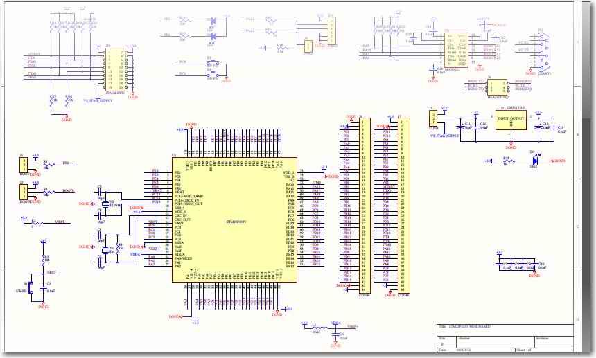

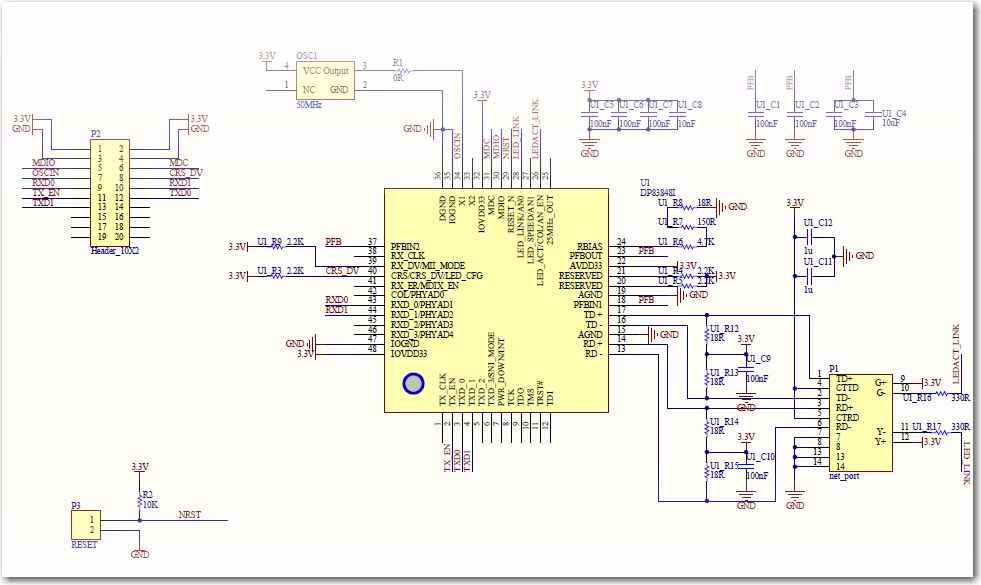

antonius
Senior
Posted on July 30, 2015 at 16:26
The Schematic, I changed the crystal of STM32 to 25MHz...and see what happens...
STM32 schematic, I changed to STM32F107VCT6 and 25MHz crystal
