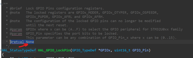

File: stm32u0xx_hal_gpio.c
  * @brief  Lock GPIO Pins configuration registers.
  * @note   The locked registers are GPIOx_MODER, GPIOx_OTYPER, GPIOx_OSPEEDR,
  *         GPIOx_PUPDR, GPIOx_AFRL and GPIOx_AFRH.
  * @note   The configuration of the locked GPIO pins can no longer be modified
  *         until the next reset.
  * @PAram  GPIOx where x can be (A..F) to select the GPIO peripheral for STM32U0xx family
  * @PAram  GPIO_Pin specifies the port bits to be locked.
  *         This parameter can be any combination of GPIO_Pin_x where x can be (0..15).
  * @retval None
HAL_StatusTypeDef HAL_GPIO_LockPin(GPIO_TypeDef *GPIOx, uint16_t GPIO_Pin)
HAL_GPIO_LockPin() should return HAL_StatusTypeDef.
But in Doxygen None

Hello @ATret.3
Thank you for bringing this issue to our attention.
I reported this internally.
Internal ticket number: 218966 (This is an internal tracking number and is not accessible or usable by customers).
