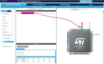

STM32Cube MCU Package for STM32U0 Series 1.3.0 (Error for SWO)
ATret.3

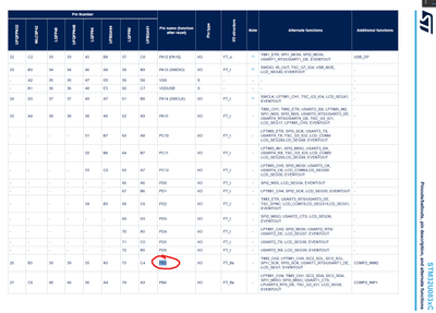

STM32Cube MCU Package for STM32U0 Series 1.3.0  + STM32CubeMX 6.15.0 + STM32U083RCT6
You can configure the SWO output in the configurator (CubeMX), but in fact, SWO is not present in the microcontroller.
KDJEM.1
Hello @ATret.3 ;
The issue is fixed in STM32CubeMX 6.16.0 version.
Thank you.
Kaouthar

STTwo-32
Hello @ATret.3
Thank you so much for escalating this behavior. The SWO is not supported on all MCUs based on the Cortex-M0+. So, this should be a wrong behavior for the STM32CubeMX that i've escalated for correction on the future (under internal ticket number 218523).
