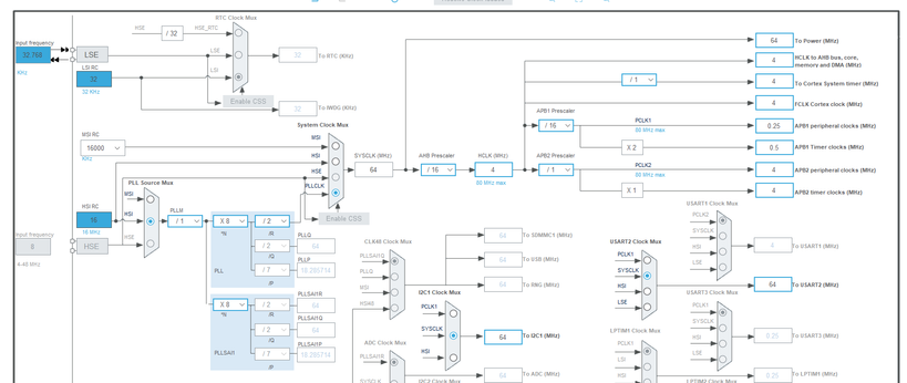

I'm trying to decrease the clock speed of TIM3 on my STM32L452RET6 (NUCLEO-L452RE) and i've run into issues. I think i figured it out already but I just don't understand why the problem is. My clock tree looks like this in CubeMX:
With this configuration and the default generated code the SystemClock_Config function looks like this:

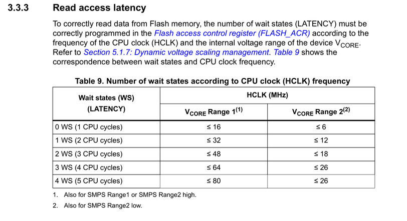

 The problem is that it goes into an infinite loop at HAL_RCC_ClockConfig function. And no, it doesn't reach the Error_Handler function (according to the debugger). And after some digging I've found this table in the RM:
According to this the flash latency is correct, because my HCLK frequency is less than 16MHz. But if I set the flash latency to 1WS (FLASH_LATENCY_1) it starts working again. Does anyone have an explanation of why that is? It a bit annoying because i need to rewrite this every single time a regenerate the code.
