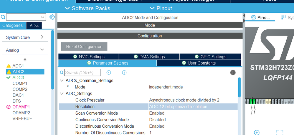

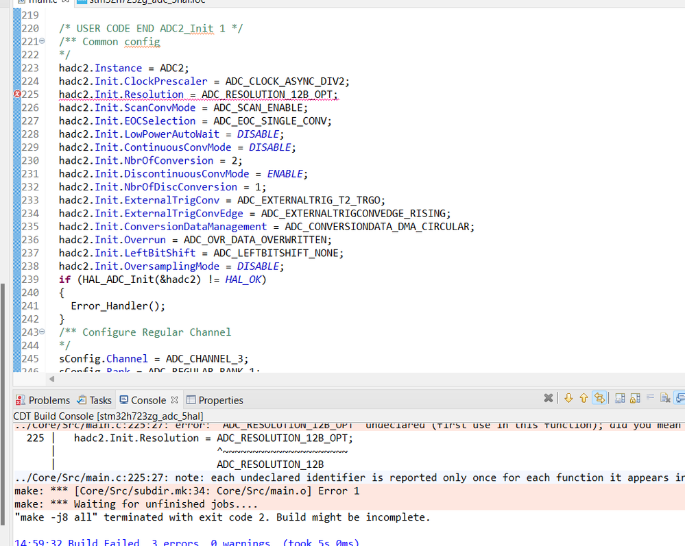

also,I found multiple cube ide bugs for stm32h723, I'll leave another example below .Before h7, I worked with the g4, f2, f4 series without any problems.Working with h7 is scary.
It would make sense to limit this thread to one problem only, that is the RCC_HSICFGR, which was incorrectly referred to as RCC_ICSCR.
For other problems, like the one with ADC_RESOLUTION_12B_OPT, it is better to open a new thread, otherwise other readers will be confused.
