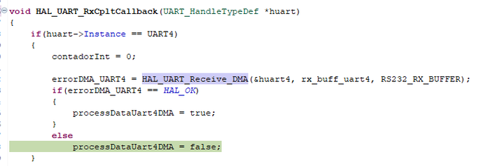

Now I am doing this to debug the errors
Variable errorDMA_UART4 has the value HAL_BUSY
In the function HAL_UART_Receive_DMA it entries into the conditional sentence:
        if (huart->RxState == HAL_UART_STATE_READY)
and it seems it returns HAL_BUSY in the line:
        return (UART_Start_Receive_DMA(huart, pData, Size));
Because it does not stop in other call to return. But looking into the code, UART_Start_Receive_DMA returns nothing but HAL_ERROR or HAL_OK.
waclawek.jan
You don't check for HAL_BUSY anyway, you check for HAL_OK. So UART_Start_Receive_DMA() returns HAL_ERROR. Find out, why.
Thank you for your quick response.
It is returning HAL_BUSY. I has been checking if NOT HAL_OK since I detected the loss of data frames and I didn´t know what was happening. As I am debugging I know that always it entries in the NOT HAL_OK condition is because it returns HAL_BUSY.
Thank you
