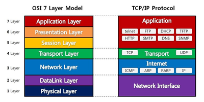

Here's a diagram showing where SNMP appears in the stack:
source: https://stackoverflow.com/a/67109048
So you can see that it's well-isolated from the hardware.
All SNMP messages are transported over UDP.
