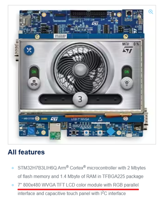

Look at the STM32H7B3I-EVAL it contains a 7" 800x480 WVGA TFT.
It uses Rocktech LCD, part number: RK070ER9427-CTG
For the options you suggested I can't tell. You need to check from your side.
For HDMI you need indeed a HDMI converter. For ADV7511: I don't know you need to check with its manufacturer: Analog Device.
There is a board provided by ST: DSI to HDMI adapter, but unfortunately STM32H7B3 doesn't have DSI interface. I don't know if there is a LCD-TFT to HDMI converter bridge is available from ST.
