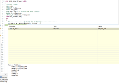

Hi ST Community,
I'm facing an issue with FatFs on SDMMC where f_open() or even f_mount() returns FR_DISK_ERR, even though the SD card is initializing correctly at the HAL level.
Here's a summary of the problem and what I’ve verified so far.
  • HAL_SD_Init() completes successfully
  • Card information is read correctly:
    • CID
    • CSD
    • RCA
    • Capacity (LogBlockNbr, LogBlockSize)
  • SDMMC interface appears operational
  • Raw HAL read/write tests (CID/CSD) work fine
I would be grateful if ST experts or anyone familiar with SDMMC + FatFs integration please help me to resolve this issue :

Hello @samuel_l
Please refer to the example FatFs_uSD_Standalone on STM32CubeH7.

I expect that the SDCard/eMMC chip is new and does not have a file system on it yet. I.E. it needs to be formatted.
