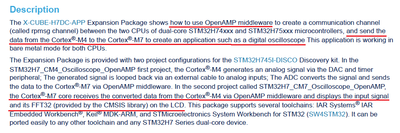

Hello everyone,
I am using Nucleo H745ZI dual core and I want to communicate intercore by OpenAMP.
The ST only giving example send message from core M7 to M4. But I want to send message from core M4 to M7, I tried follow the OpenAMP flowchart but not working.
Do anyone has the example of OpenAMP send message from M4 to M7?
mƎALLEm
Check the oscilloscope example X-CUBE-H7DC-APP, it is using OpenAMP. Most probably CM4 is converting an external analog signal and it is sending the samples (using OpenAMP) to CM7 to display it and apply the FFT.

Indeed, it does (from the data brief:(
