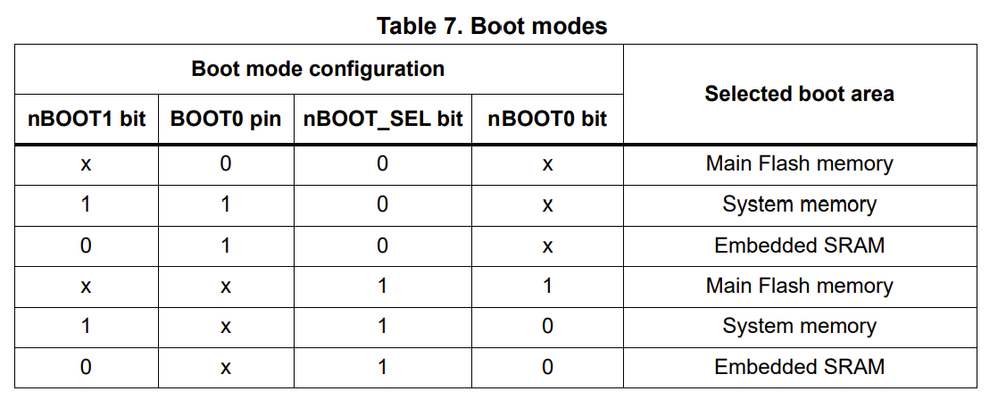

There is a LED-BLINKING program programed by distributer in main flash memory. I have tried to pull BOOT0 to VCC and reset the chip. But the LED on the board is still blinking. I got confused why this chip doesn't go to bootloader but still excute program in main flash memory instead.

Boot0 and Reset may be remapped and set by option bits. Only possible way to attach to such a device in my understanding is:
- Pull and keep reset low
- Power up device
- Connect via SWD under reset
Get a working G0 nucleo or disco board to try out the procedures and your understanding. Then review the board you have and what is happening with the board.

AN2606 start pattern 11
Boot0(pin) = 0, nBOOT0_SEL(bit) = 0, BOOT_LOCK(bit) = 0 and main Flash memory empty
when this is default config your MCU start system memory bootloader and you can load first code UART... , but for next starting you need method in your code to jump to system bootloader... read AN

If I set nBOOT0_SEL bit to 1, nBOOT0 bit to 1 (boot from main flash memory and BOOT0 pin are not connect to boot mode), and remap SWDIO, SWCLK to reset state (SWD are disabled). I wonder is it possiable to program this chip again?

Yes seems your blinky board have WTF setup from line 4.
Then you only can use SWD to get it back or replace chip on board with empty one.
SWD under reset is always work onle RDP level 2 i mean bloack it.
