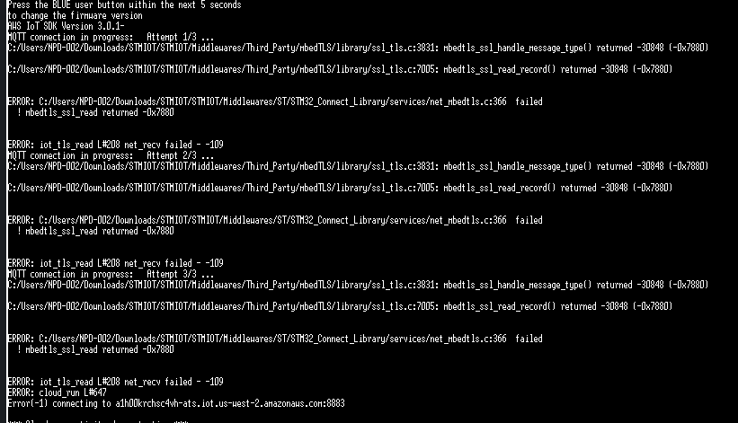

After building and running the project the following errors occur and do not connect to AWS.
I have downloaded the root CA and device certificate and private key when I created the IoT thing in the AWS.
However, it gives the following error.x509_verify_cert() returned -9984 (-0x2700)
Attaching image for more information
Can someone give me directions who were successful in dealing with this error?

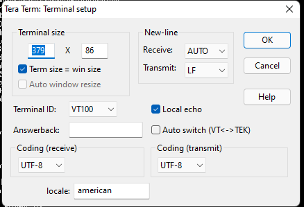

  1. I am using X-CUBE-AWS 1.4.1 version.
  2. Root CA was from AWS website when I created the thing in IoT Core
  3. However, now updated it Amazon1_Usertrust_Baltimore.crt as root CA -- The X.509 error disappered. However, the remaining two errors remain. I open the device certificate and private key in notepad and copy and paste it in the terminal. The device certificate and private key are created in the AWS website when I created the thing in IoT core. Here is the update of the error
  1. I am using teraterm for the project. Below is the image of the tera term configuration
0693W00000JMhljQAD.pngIs there a way to directly insert the device certifcate and private key in a file somewhere?
Regards
Vamshi
