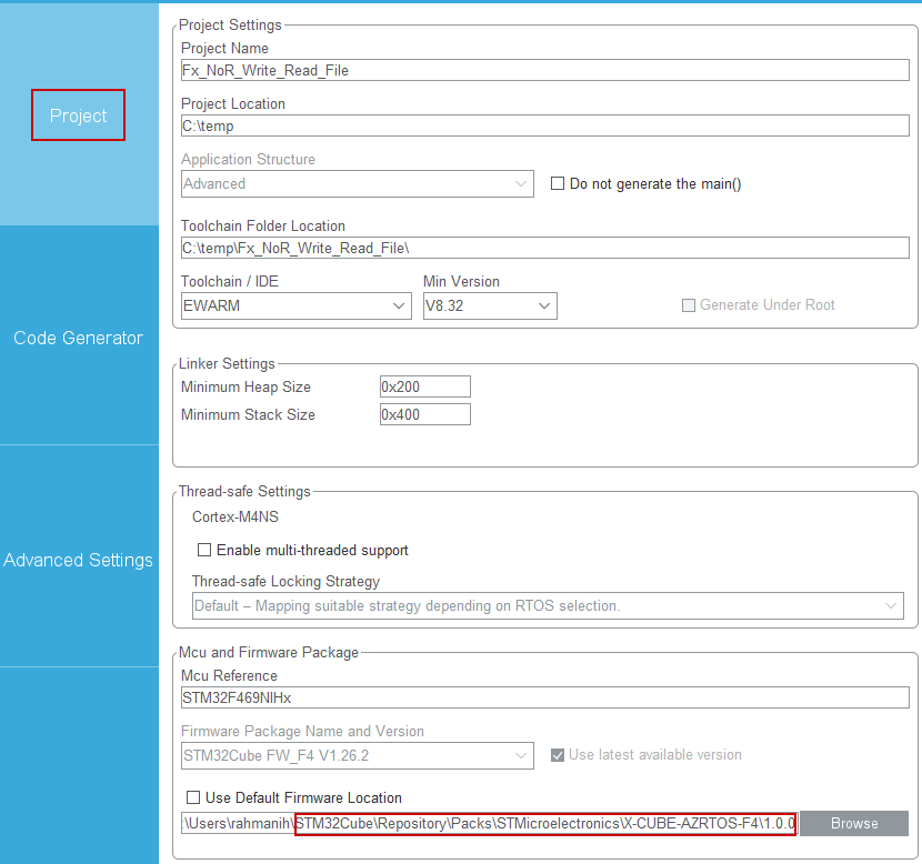

Haithem Rahmani
Hi @JAgen.1​,
under the STM32CubeMX "Project Manager" panel select the "Project" Tab and edit the Firmware location as shown below:
regards
Haithem.

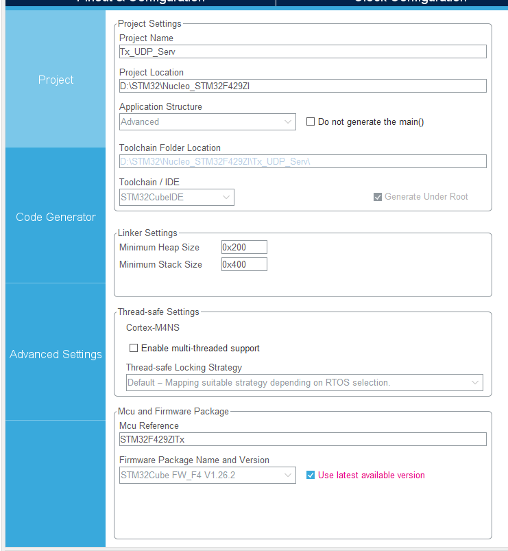

JAgen.1
Hi Haithem Rahmani,
thank you for your help ! unfortunately i do not get the line you mention (Firmware location) .
0693W00000JN0qTQAT.pngRegards,
