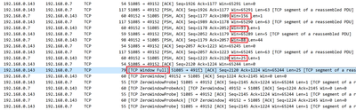

In my program, I am using the TCP Server example from the Cube IDE. I just added a function that copies received frames to my buffer, which I then handle myself in another function. The TCP client sends me 84 byte frames. After receiving 1530 frames, communication breaks down. No connection to the Nucleo board, PING does not work. Wireschark shows that the board is sending back a TCP ZEROWINDOW message. The problem always occurs at the same time. The rest of the program works all the time. The problem is only with the ethernet.

TCP/IP has a sliding window mechanism. Every frame sent has a sequence ID and it is up to the receiver of the frame to tell the sender that the frame sent was properly processed.
This happens with ACK + an update of the sliding window. This window defines the max amount of data that can be sent without an acknowledgement by the receiver.
The way to initiate this mechanism side STM is with tcp_received(tpcb, p->tot_len), this statement actually moves forward “tail” of the sliding window with tot_len bytes.
If you forget this statement, you will run out of space and in Wireshark you will see TCP WINDOW FULL as indicated below.
