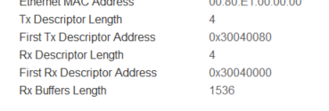

thanks for your quick response. Let me start replying to the latest point. Being an H7 board, I'm using (depends on the attempt I'm trying) addresses in the range 0x30020000 up to 0x30040000, therefore SRAM 2 and 3, as I understand. They should be reasonable memory areas with a reasonable available space.
I have some questions on the memory allocation on your first reply though. CubeMX 6.9.1 does't allow to provide RxBuffer length:
For this reason I had to define in the ethernetif.c file the dedicated RxBufferLength (Rx_PoolSection in my case) and then allocate a share of SRAM memory to it in the linker script. I don't get the need to add the heap section which is aready defined in the LwIP section:
Is the usage of AXI RAM mandatory? I must say I don't know what the liker script you posted is doing with those instructions.
All of these configurations must be coherently aligned with the MPU, is that correct?
My first doubt is the .ioc configuration, if all the registers have been confgured correctly. That is the first thing I must make sure of. Secondly, the area memory.
Thanks in advance,
Zaack
