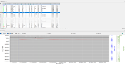

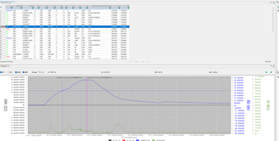

@JoeMck Would you attach your trace and voltage of CCx and VBUS.
Best regards,
FBL
JoeMck
The top one is scaled to see VBUS, the bottom to see CC.
