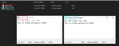

I've updated the following example, that uses FileX in standalone mode, to open 2 files and it works correctly.
https://github.com/STMicroelectronics/STM32CubeU5/blob/main/Projects/STM32U575I-EV/Applications/FileX/Fx_File_Edit_Standalone/FileX/App/app_filex.c
below the screenshot of the uSD content and attached the modified source code.
hope this helps.
