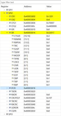

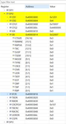

I also include 2 screenshots with state of all SPI2 registers in the moment (breakpoint stop) before HAL_SPI_TransmitReceive() is loading SECOND byte to TXDR for first and second transaction to see the difference. It is just one flag: TXTF which is set on second transaction but not on the first one.
First time:
Second time:

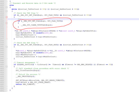

Update!
I followed observed difference in SPI transaction 1 and 2 -> TXTF flag. When I clear TXTF flag, see below in red, in HAL_SPI_TransmitReceive() function, then I unlock transmission to go on; it seems working fine, will check more tomorrow. It is ad hoc experiment, more checks needed but at least traffic continues...

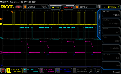

And screenshot from the scope :)
