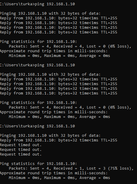

but he when I ping the address I get :
after I do several pings it stops working which I do not understand. and I will have to run to the code again then it will work for several pings then stops. The test is done with a switch in the middle and also directly to pc with all other network connection disabled but the issue still continue.
I have tried several examples provided by STM32 for nucleo-h743zi ethernet but still does not work (the is the setup is closest I got).
I have been facing this issue with this board for a long time, I need help or solution
I searched in the community but nothing helped.
this was pervious post :
thanks in advance

It seems that the driver runs out of buffers. Therefore the question is why the buffers are not released. Maybe HAL_ETH_TxFreeCallback() function is missing.
You must use at least CubeH7 v1.10, because all of the previous versions are dysfunctional. But do not think that the current version is reliable:

Yeh, looks like a buffer issue, or issue with DMA descriptors for ETH DMA located on a non-cached (or "write-through") MPU region.
You configure the total 4GB space as "not cachable"?
You add regions with "bufferable" (for 512 bytes)?
OK, makes a bit sense, except: why not using entire memory space as "not cachable"? (then it might work).
Important is: the ETH DMA descriptors (and maybe its transfer buffers) have to sit in a region with a specific cache policy (e.g. "write-trough").
If one DMA descriptor, one buffer is cached - the ETH DMA would not get anymore updated MCU instructions (e.g. that this descriptor is new) or the MCU does not see anymore the received data placed by ETH DMA (and does not act anymore, because MCU DCache sees still old data).
I would check also carefully if the MPU config matches with the source code (how many descriptors, on which location to place), and the linker script (reserved sections). Maybe at least one ETH DMA descriptors sits outside the "non-cached" region (or the .Rx_PoolSection) - it could also result in "lost communication").
I have it working on several projects, but I can remember it was "tricky" to bring all into alignment (linker script, MPU config and to use the right cache policies for ETH DMA sections).
