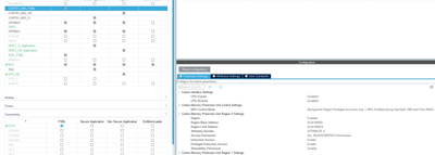

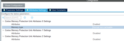

Among various attempts, I was also trying to use the Memory Management Tool to move the RAM and FLASH regions in order to assign explicitly regions for the Ethernet descriptors. However, The Tool does not let me move these regions (my project is in XiP mode, if it matters).
I have then some questions about these two related issues:
A) Ethernet and NetX Duo Initialization
1. Am I missing some software initialization step, or misconfiguring the hardware in some way? I went through many examples and I do not find an answer, also given that the configuration sometimes differ among them.

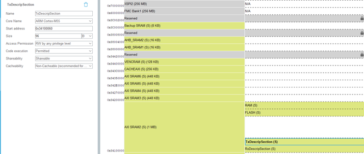

B) Memory Management Tool (XiP Mode)
2. Assuming explicit descriptor placement is necessary for a fix, what is the procedure to unlock, and modify the default memory regions within the STM32CubeMX Memory Management Tool, so that I can define custom memory segments?
Any guidance on resolving the MAC silence or navigating the memory configuration tool would be highly appreciated. Thank you. I attach a .zip file with all the code and the .ioc file.
15 REPLIES 15
Hello @damole,
The reason the descriptors are in a suspended state is that they are not initialized or configured by NetX Duo in the first place. If you inspect the NetX Duo initialization function in your project, you will find that it is empty. You cannot expect the board to respond to pings or send and receive frames when ARP, ICMP, and memory allocations are not set up.
Before debugging further, I suggest examining the example I mentioned in my first reply and stepping through it to observe the required initialization tasks.

Hello @ACR,
Unfortunately I am not going any further in solving this issue. I saw your post before, and also some other related to a similar problem, but i still cannot find a solution.
However, I see from your post that you can assign the ethernet descriptors region in the Memory Management Tool. For me I was not able to assign them becasue i was not able to move the ram and the flash regions (and the descriptors must be placed in the address space occupied by the ram region). Did you find a workaround for this or am I just doing something wrong (I know that i need to activate the flag in Code Generation Configuration, but I am not able to move the regions anyway)? This would be of some help for me, thanks
Best regards
ACR
Hello @damole ,
By using the MMT I could generate a new linker script, with defined Section for both descriptors.
I am not sure about what the MMT does, I mean there are several options (cacheability, shareability,...) like below:
It seems that these have no effects, I couldn't find any changes in the generated code. There is also the MPU, where you can find this parameters.
But implementing this didn't resolve my problem.
I don't get this point, but I saw something like that in the NX TCP ECHO Client example, where the descriptors were defined in the RAM defined memory. I didn't try.
Best regards,
damole
Thanks @ACR, i will try to do so.
Regarding this:
sorry that was not clear. I mean that, at least in my project, it happens that the RAM (S) region is in an address address range that is overlapping with the range where the ethernet descriptors can be placed: if you check in the reference manual or also in the ethernet tab of CubeMX (where you can set the start addresses of the descriptors) and you open the info you will see a message saying something like "ethernet descriptors can be placed between 0xAAAAAAAA and 0xBBBBBBBB", meaning that they cannot be placed wherever you want in the memory, but they can be only in a specific range (which for me it happens to be where the RAM (S) is); I assume that this is range is the memory portion that the dedicated DMA has access to (but not sure about this).
I also saw some examples where the descriptors are in the RAM memory, and this makes me a lot of confusion, also because I am not sure that what you see in the MMT makes sense or is just random stuff if you do not activate the flags in the Code Generation Configuration, given also that there is the MPU dedicated tab that does basically the same thing.
