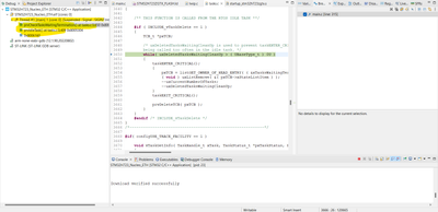

I have a problem while using lwip and freertos.
The board is based on stm32h743vih.
The mpu configuration is done correctly i think.
My problem is after i start udp server and start to send data with udp, everything is ok, but after a while i will enter a loop in xQueueSemaphoreTake an in the configASSERT( pxQueue->uxItemSize == 0 ).
I searched a lot and i saw this:
https://community.st.com/t5/stm32cubemx-mcus/cubemx-lwip-ethernet-link-thread-bug/m-p/126556
I did what it said but this time when it happens im not in the loop but the other tasks get very slow and actually a task with osdelay(1) is executing every 1 second.
What should i do?

Ive done exact the same configuration.
But i see odd behavior.
When i config only eth with rtos and lwip i see hardfault.
But with the same eth configuration and just enabling uart (no other action just hal will call uart init)
i dont see hardfault and everything work fine.
Im really confused.

Sorry for the delayed response, it turned out to simply be not giving the default task enough memory. 512+ Words seems to be needed.
‎2025-03-16 3:14 AM
I'm using STM32F746ZG-nucleo board and CubeMX 6.14.0.
Besides the stack size for Default Task, I needed to increase the stack size for ethernetif_input() task. The stack size for ethernetif_input is 350 and it overwrote the Tx semaphore which was created from heap memory.
In FreeRTOS, semaphore is implemented using queue with no payload. So it gives an error as the following.
