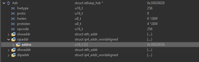

I did some further analysis of the problem. Based on the "fault analyzer," we know that there is an attempt at an unaligned access. I have checked the address of &hdr->sipaddr, which is 0x30020036, and it is unaligned, right?
Variable.JPGIf I define a new IP address for testing purposes, which I then pass into the function, my program runs without hitting any hard fault or stopping. Could you please check the address of &hdr->sipaddr when you run the program? I will attach the latest version of the code.
etharp.c
Line 1140:
ip4_addr_t ipaddr_new;
IP4_ADDR(&ipaddr_new, 192, 168, 178, 10);
IPADDR_WORDALIGNED_COPY_FROM_IP4_ADDR_T(&ipaddr_new, ipsrc_addr);
IPADDR_WORDALIGNED_COPY_FROM_IP4_ADDR_T(&hdr->dipaddr, ipdst_addr);
