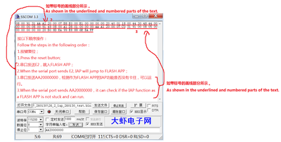

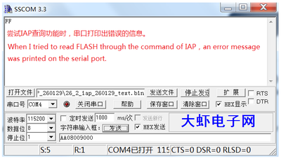

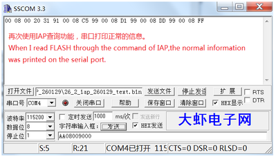

I use the code now,but have different result.
Can you tell me why?

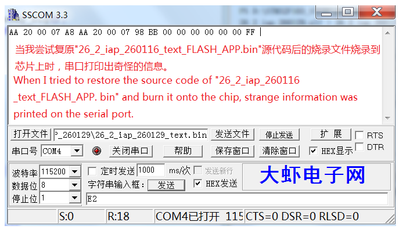

I try to restore result that shows the irrelevant information on serial port,but there are different results on the serial port.
I tried to restore the code that shows the irrelevant information on serial port,bur there are different results.

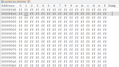

First time,I burned FLASH APP onto the chip,it isn't normal.Then I read the FLASH,it was erased.

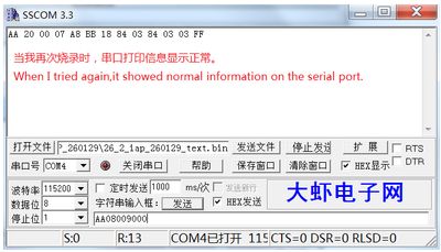

Sencond time,I burned FLASH APP onto the chip,it is normal.
It can work!
