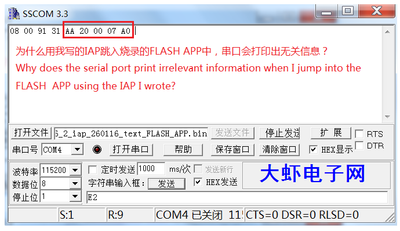

irrelevant information on serial port when I jump into FLASH APP using my IAP?

My guess is your application writes to UART1 as well.
Nothing wrong that would explain this in the code you've shown.

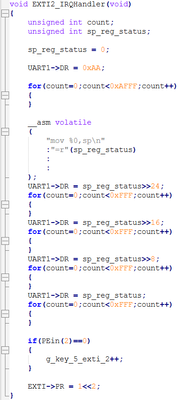

FLASH APP? It's only in EXTI2_IRQHandler().
But I didn't trigger the interrupt.

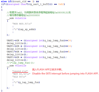

Disable the EXTI interrupt before the jump.
At least on a H7 a lot of de-inits and interrupt disabling is done before jumping.

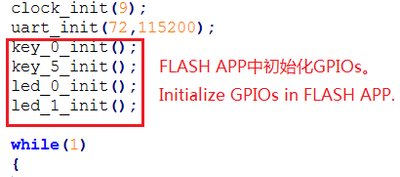

Maybe before jumping you first de-init / change the GPIO config, and that triggers the EXTI interrupt.
So try to disable EXTI first, the de-init the GPIOs.

BTW, so many (and long) for-loops in an ISR are usually not considered good design, unless you have some very specific reason for that.
Why not just set a flag and then "print" in the main loop?

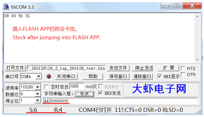

It still stuck.
If I set a flag,it is not timely enough in some condition.For example, more than 2 interrupts occur simultaneously.
 "print" in the main loop is DMA or other methods?

I'm not sure if I understand you correctly, right now it seems that the jump to the bootloader happens from within the ISR without any de-initialisations?
It sure looks like it did. The code in your interrupt is exactly what you show in your screenshot. I would recheck your assumptions here.
