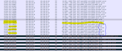

This is snip is jst before reconnecting

RBU: Receive Buffer Unavailable
So it looks like you're receiving many many small packets.
It guess that these each "use up" an RX descriptor, and depending on your lwip settings also a complete packet buffer (pbuf).
I would largely increase the number of RX descriptors (that doesn't take too much memory), then also increase the numbers of pbufs.
As always, make sure where that memory is placed, check there's no overlap with RX / TX descriptors.
Also check how and how often your application handles RX packets, maybe you need to speed that up.
If you receive a high number of small packets in a short time, your application should handle that accordingly.
And finally: the HAL ETH driver and lwip are quite heavy things to handle, as soon as data rate goes up or some special features are required, you must dive into to that and understand more in detail what's going on there.
