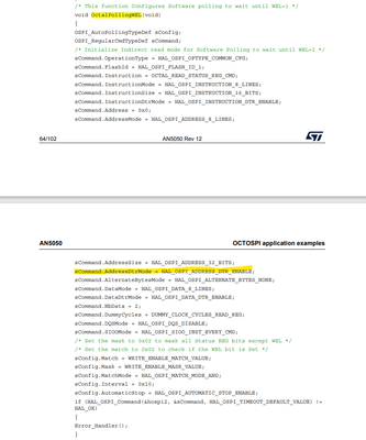

I'm encountering an issue with OCTOSPI auto-polling on the STM32U5G9NJ-DK1 Discovery Kit while following the "Octo-SPI FLASH in Regular-command protocol example" from AN5050 (Rev 12, February 2025). Specifically, in the OctalPollingWEL() function, HAL_OSPI_AutoPolling() always times out while waiting for HAL_OSPI_FLAG_SM (Status Match) to set. It calls OSPI_WaitFlagStateUntilTimeout(hospi, HAL_OSPI_FLAG_SM, SET, tickstart, Timeout) and returns an error, triggering Error_Handler().

Hello @PAV;
First of all thank you for updating post.
The configuration depends on the memory mode selected.
Below is the configuration for the OctalPollingWEL function in AN5050:
Thank you.
Kaouthar

Hello @PAV and welcome to the community;
Are you configuring the memory in DTR mode?
In your configuration, you have disabled DTR mode for the address
sCommand.AddressDtrMode = HAL_OSPI_ADDRESS_DTR_DISABLE
I think it should be
sCommand.AddressDtrMode = HAL_OSPI_ADDRESS_DTR_ENABLE
Also, I recommend you to look at STM32CubeU5/Projects/STM32U5x9J-DK/Examples/OSPI/OSPI_NOR_MemoryMapped at main · STMicroelectronics/STM32CubeU5 · GitHub example may help you.
Thank you.
Kaouthar
We have not made any changes to the code; it has been taken directly from the application note as a reference. However, we are facing an issue in the OctalPollingWEL() function, while the AutoPollingWIP() function works fine. For your reference, I am adding both the APIs below.

KDJEM.1
Hello @PAV;
Thank you.
Kaouthar
