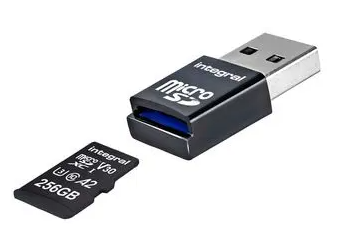

You can get USB "pen drives" which take a uSD card; eg,
So you could just develop a USB MSC Host - and use one of those to provide the uSD Card support ...
Thank you @Andrew Neil  :)
