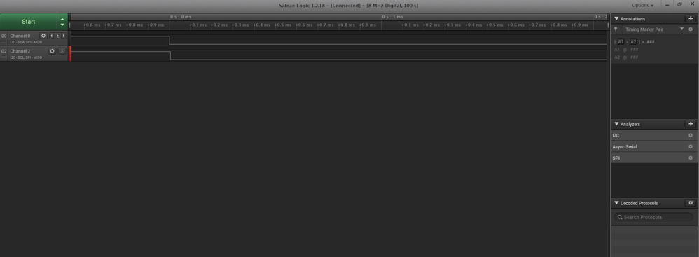

When running directly, I just set the lines from transmission, and boom.
This is when I run with no breakpoint (it remains like that and there is really no signal even very fast)

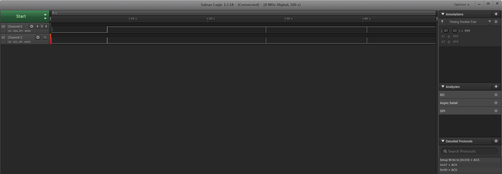

0693W000007DLglQAG.pngwhen running step by step, it's very slooow, but it works better (it still finishes by a hardfault, maybe from mutex I'll deal with it later). Each 3 peaks are a byte sent from the same 3byte frame.
