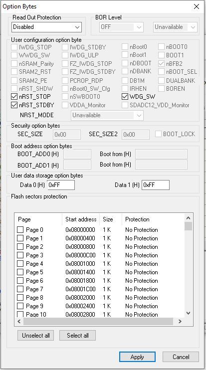

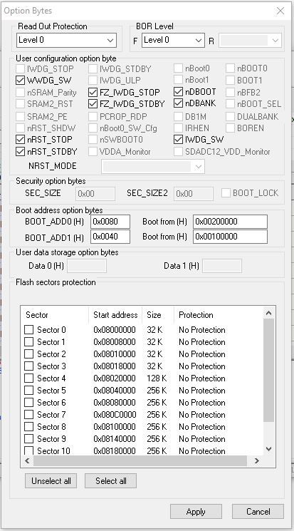

I also checked the options bytes configuration and it seems good for the 2 boards.
I did a test with the Flash Loader Demonstrator from ST (with empty MCU FLASH or not) and I have the same issue, no response from the target, the bootloader cannot be started.
